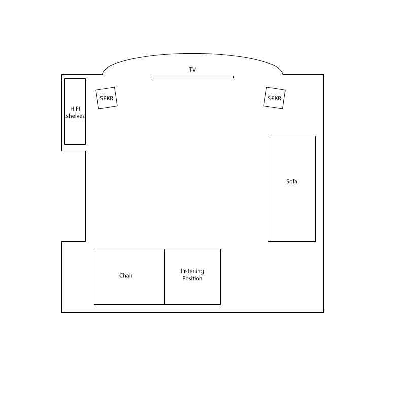

My room is around 12ft x 12ft square but has 2 alcoves either side of a fireplace that are around 1ft deep. The speakers are positioned at the edge of a bay window and the tweeter is 0.5m away from the wall with plenty more space into the bay behind it. The outside of the speakers are 0.75m away from the walls. Hifi runs off a different main to TV. I’ve tried to upload a bad diagram.
