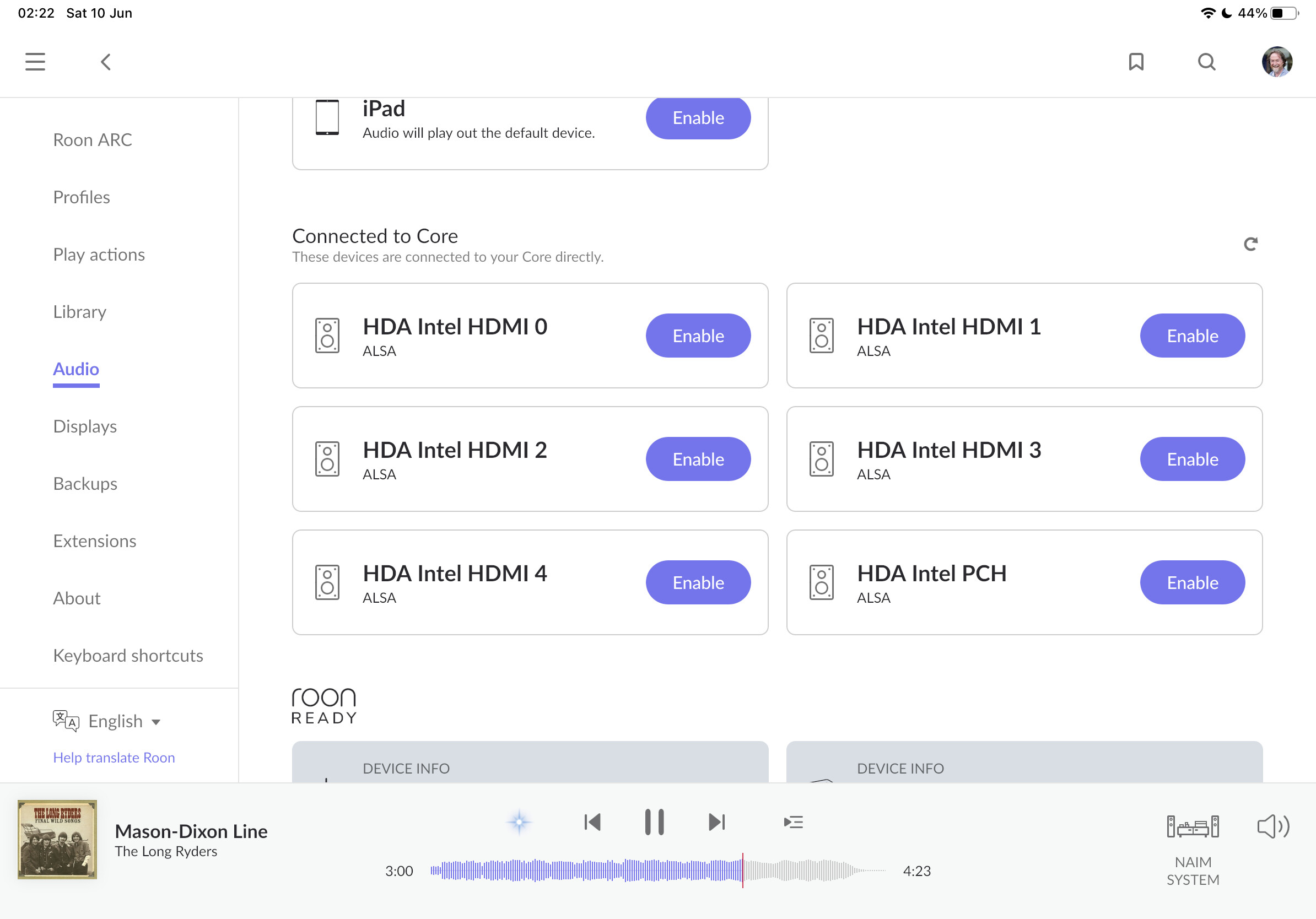

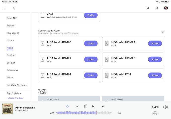

So the meridian is connected by USB to the mac but in roon settings audio settings the meridian doesn’t show up as connected to core to allow you to enable it?
.sjb
Correct. And Meridian streams Apple Music from the MBP to the SN3. Crazy, Apple Music works. Neither Roon nor Quobuz works.
I use an explorer on my roon core. Try it in a different usb socket because it definitely should work.
Fixed it. Needed to enable Meridian Explorer in Audio Settings. All three Meridian lights are on now. Also runs Quobuz, too. Sorry for the false alarm.
