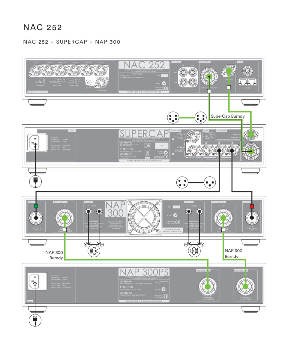

Connection of Nap 300 power amp and power supply to NAC 252. I have a Nap250 and Nac 252 pre amp
and am thinking of upgrading to the Nap 300 units. I also have a Superline. Basically - is it possible to connect the Nac252 pre amp to the Nap 300 P/S? I see that the 300 has 2 inputs (presumably left and right) and my 250 only has one - left and right combined - presumably. Just want to make sure I can definitely make the connection between the 252 and the 300 combo.
Yes, the pre-amp signal goes from the Supercap that’s powering the NAC252 to the NAP300 via a pair of handed DIN4-XLR leads. The Supercap has three stereo signal outs, so you’re more than covered here.
Connecting a 252 to a 300 power amp is not only possible - they were the natural partners designed to work together within the Classic range.
Make sure that the seller remembers to supply the two leads that you will need, which are provided by Naim with the NAP300, and make sure the L and R cables are connected to the correct sockets.
That’s fantastic. Thanks so much. I will now go ahead and purchase the 300 and P/S.
Also thanks for diagrams. Will
Thanks so much for the info. The diagrams wiill help enormously.
Thanks again Will
I have a copy of this diagram printed and stashed in the fraim base. So handy!
