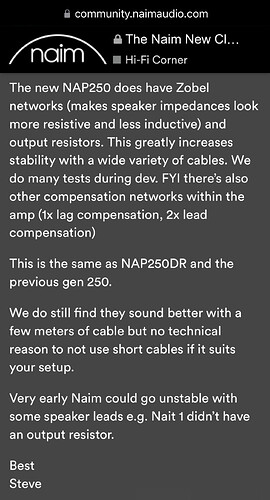

But Richard, on the launch thread for the 200 series, Naim weighed in that that hasn’t really been true since the Chrome Bumper days and while they recommend at least 3.5m of A5 for sound quality, the amps are inductance tolerant from Olive and from DR can be used with pretty much any cable of any length.
We even talked about ammending the FAQ and you said you’d look into it.
Yea Steve said a too short cable can sound “nervous” and a too long can sound boring and to relaxed. Classic amps and onwards was not sensitive to the specifications more than that it can affect how the cable sounds. I believe this was valid with classic and onwards and that Olive and earlier was were problems could happen if not following the guidelines. Steve Sells is Technical Director at Naim and has been there since 2001.

Yes, I need some input from Steve first, as there have been issues with high capacitance and low inductance cabling. Just because an amp will survive the use of inappropriate cabling doesn’t mean it’s a good choice. My own NAP250.2 for one example, where I tried some Kimber cable on it and it was most unhappy. Now, it may be that it was robust enough that using that cable wouldn’t have damaged it, but it definitely ran very hot and sounded awful, so hardly a great match.
IIRC Steve said they have had a zobel network of some sort since all but the earliest CB integrateds.
The amps all have had zobel networks AFAIK, but it’s the added inductance that they don’t have.
Yes,sorry meant the inductance.

I would assume the challenge with Kimber cable and similar geometry cables is very high capacitance in the area of 3-800pF per meter which is very high indeed. Their inductance is low however. A cable maker told me it’s not the specific numbers of inductance and capacitance that is important for naim amps. It’s the relationship between those values that is. Non confirmed information though.
If you drive an amp really hard then it can get fairly hot. That’s fine, and there’s a thermal trip to protect it if it gets too hot. If it gets really hot just through normal use or with no music playing then that’s a problem.
Yes, as per the FAQ recommendations, ideally you want a cable that offers a combination of low capacitance and moderately high inductance.
