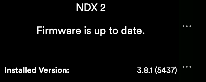

And what is the verision of the ndx2?

Dear All, Thank you for the advices. I think the problem is in sort of instability of the network (Internet) connection. @Blitznack : what do you mean by version of NDX2?
He possibly means Firmware version is up-to-date

excactly that, check if your firmware is up to date.
