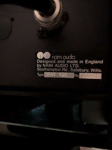

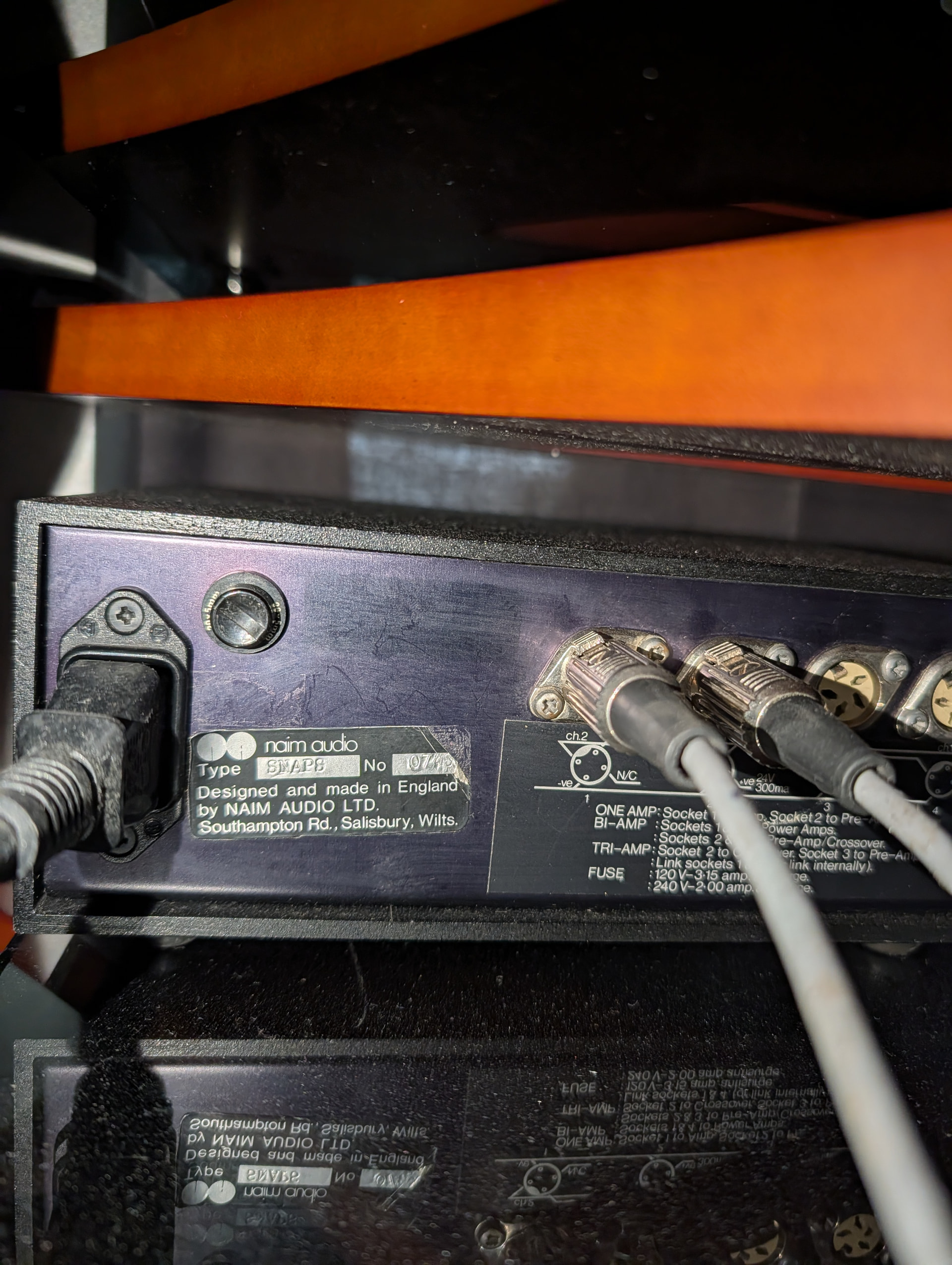

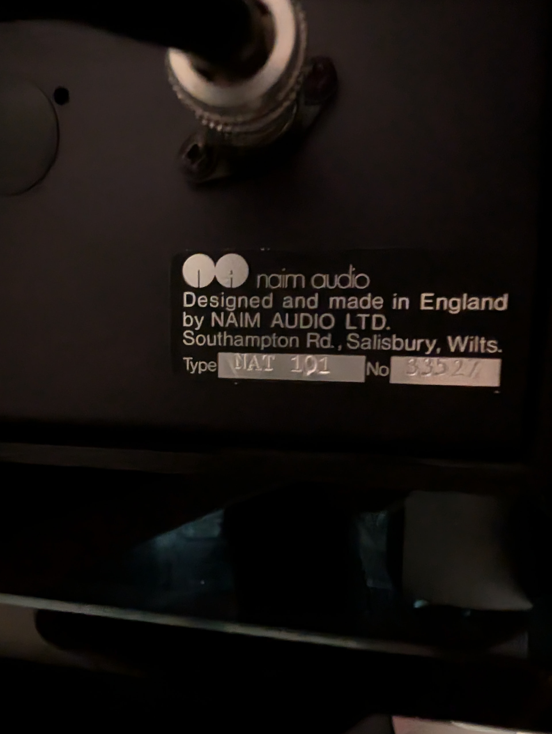

Just reading the serial numbers on the Nat 101/snaps and wondering if Naim sold them paired originally,ie consecutive serial numbers?
101 is 33x
Snaps 07xx
Which by my research puts them around 6 years apart
Is there any reason apart from me and my bizarre obsessions to get them closer and possibly match. By that I mean any technical revisions which may improve or degrade the sound due to the
age difference
It may sound daft but the red to green lamp change has got me wondering if my bulbs correct.
It is my understanding that one of the outputs for Nat 101 was set to 24.5 volts for use with the 101. On my snaps this input is marked with a yellowish dot. Mine has had a green LED from new if this helps whereas a hicap bought at the same time has a red led.
