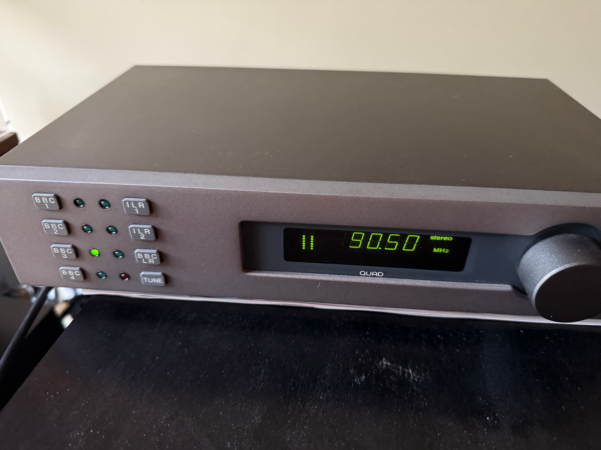

Tried a Quad FM4, which iirc @davidhendon uses.
Photo below, shows tuner connected to the direct aerial feed, in lieu of NAT01.
It shows 6 bars and Stereo - perhaps DH recalls whether that is the maximum?
By contrast when connected to the amplified feed at the other end of the house, usual connection is NAT02, it is one bar less after a long run of coax.
Looks like a return visit to the factory, perhaps @NeilS would be kind enough to confirm?

My FM4 is boxed up and in the loft. I have two NAT 05 XS tuners that are currently in use. The signal strength display of the FM4 varies by version of the FM4. But that does sound about right.
Anyway as Neil says, or paraphrasing it, if the NAT02 is ok when substituted on the feed for the NAT01 when it’s failing, then you probably will have your answer.
