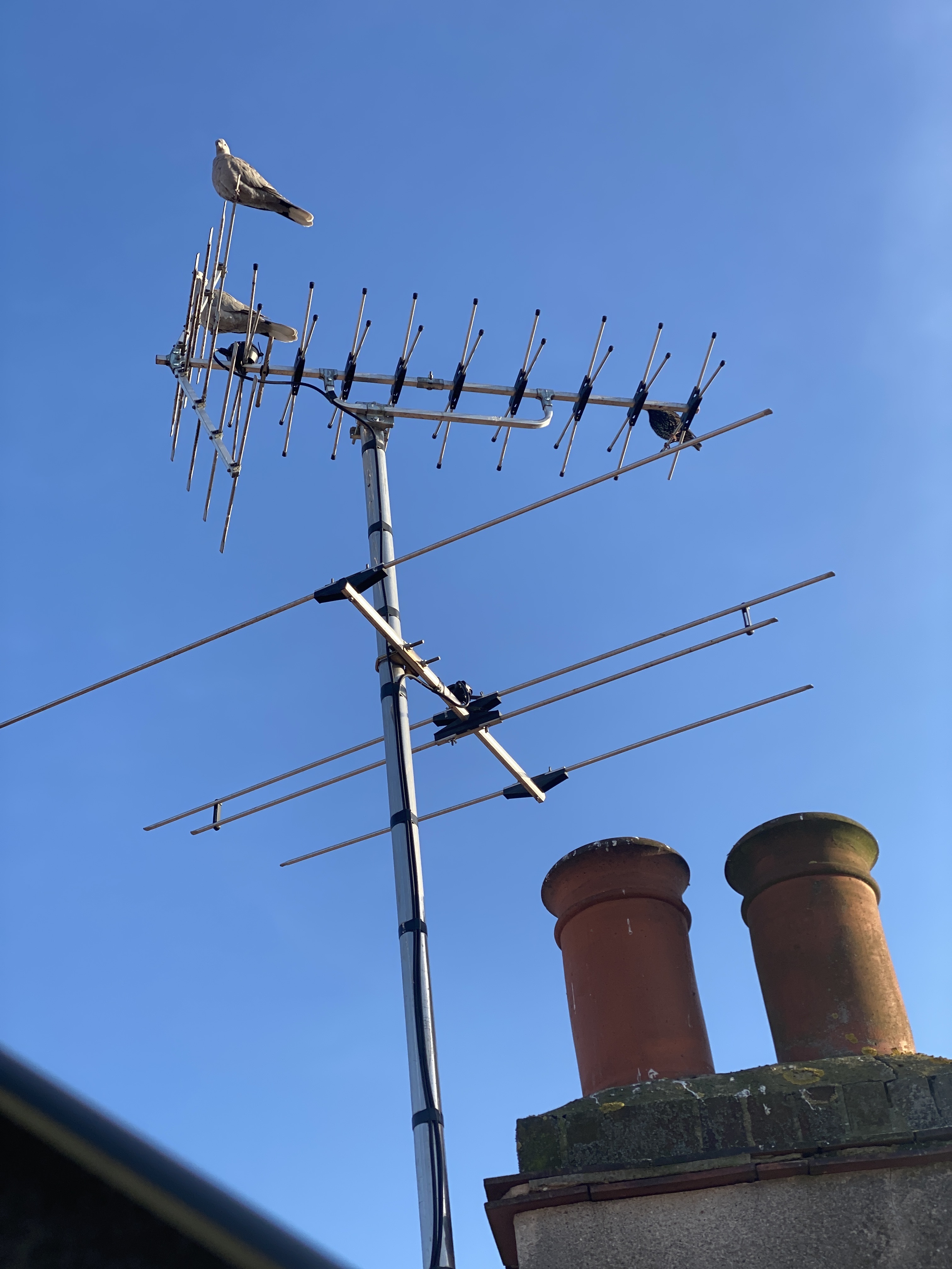

This is my aerial, Antiference I think
Wasn’t that expensive and if you have a local transmitter it gives a very strong signal. My 01 is very happy with it.
Correct - Antiference FM1083T

My aerial is a similar set up to yours with four elements. It works well in central London and was recommended by the installer as the best choice short of an enormous Ron Smith rig.
