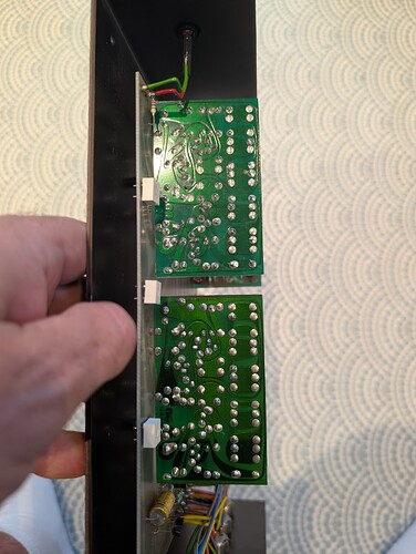

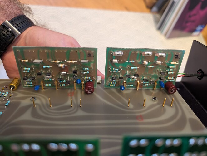

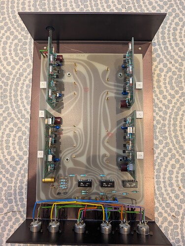

Havnt been able to find much information and no real pictures to compare with.
I have a Naxo 2. It’s setup with 4 NAF boards and internally looks in great condition.

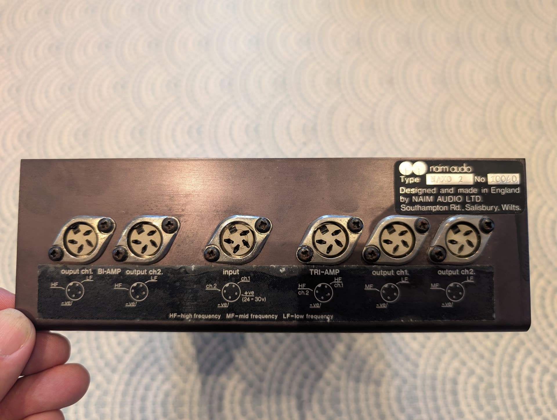

Id like to connect it to a Nac42 (not a .5 version) via a SNAPS. The amp being driven is a nap160 and I guess I’ll start looking out for a second one. (Speakers are SBL’s).
Is it a case of SNAPS socket 2 into the Nac42 and SNAPS socket 3 in the Naxo? Then sockets 1 and 2 on the Naxo to the respective amps?
With this older Naxo it doesn’t look like it would be able to take power from a Hicap? I understand that Naim/class a can modify the 42 into a 42.5 to use a Hicap instead but then I guess the Naxo would be the issue. The board is very different to that of an olive 2-4 Naxo I have. Hoping that the combo is possible of 42/snaps/naxo2/nap160 X2
