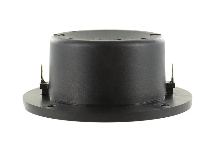

The new replacement Scanspeak tweeters appear to have the connectors coming out of the sides - see the pic below;
This means you will most likely need to make some small modification to the retaining ring and maybe even the sprung plate and cabinet (difficult to say for sure without having tried).

Yes the diameter of the replacement tweeter and the PCD of the fixing holes are the same.
