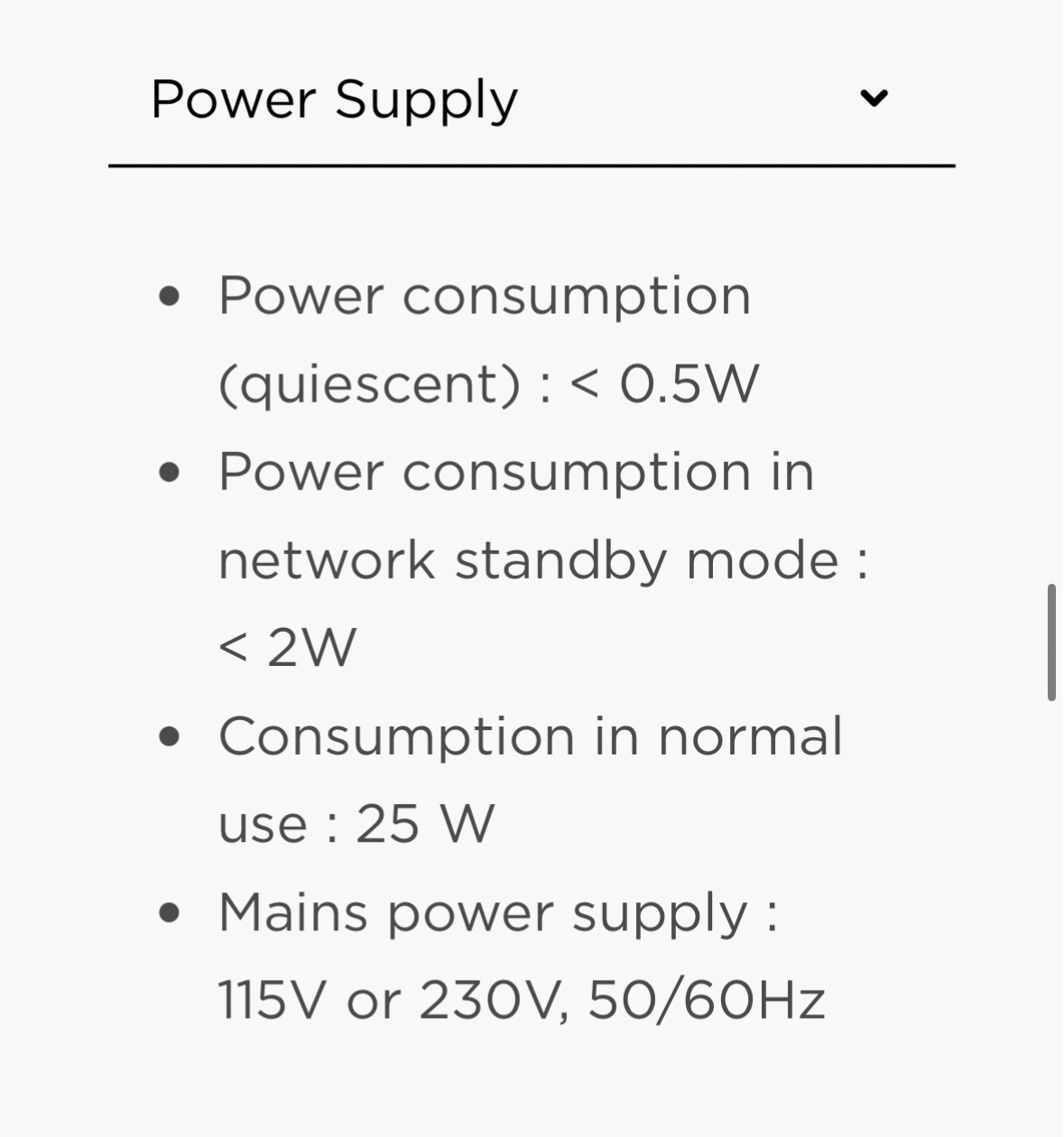

25W when on. I have mine on 24/7 and just put it off during thunder.

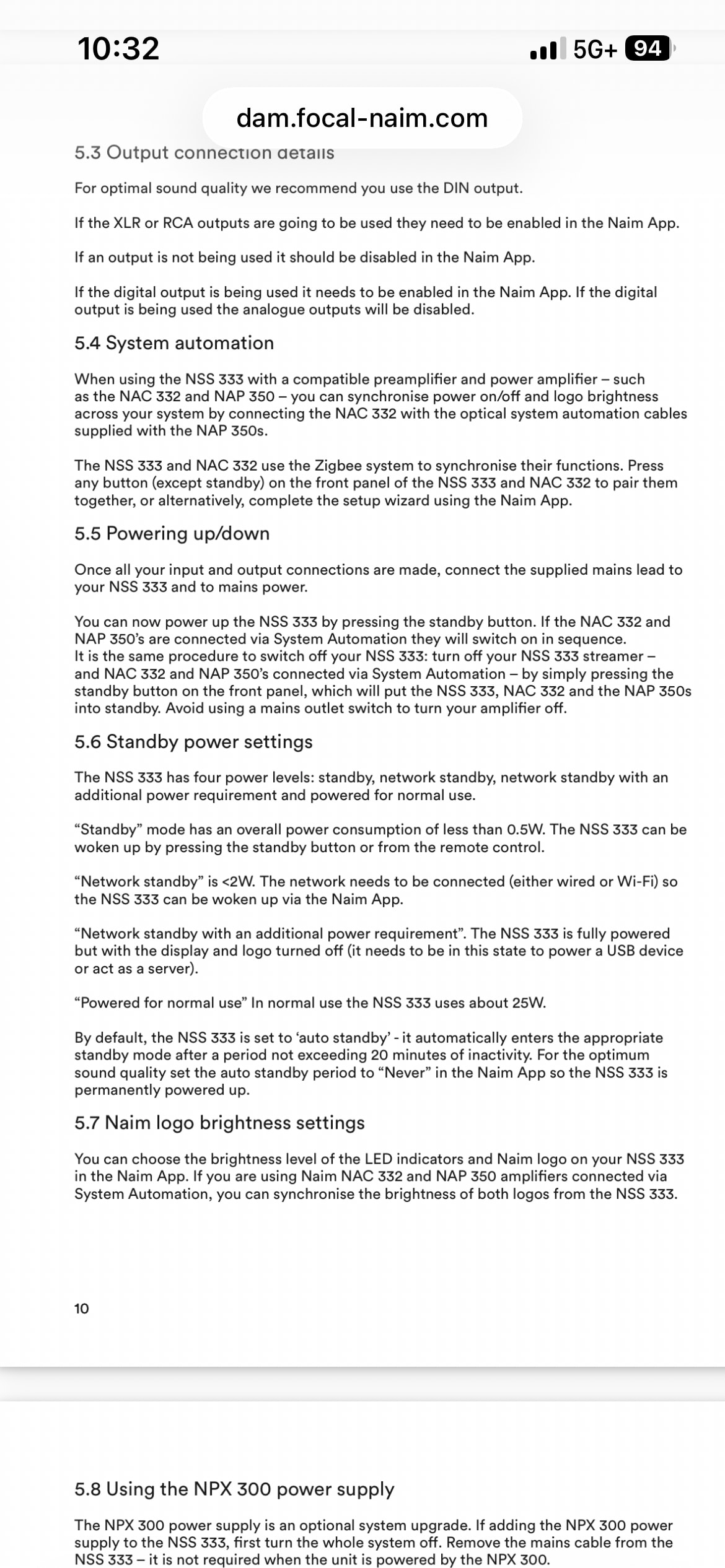

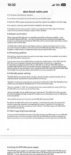

There are several “standbys”. It needs to be in network standby to be turned on by the Naim App.
I use system automation and standby is set to never. I put into standby before bed. Sometimes the next day it does not come out of standby with the app. I would assume it should be fairly consistent.
There are three modes, on, network standby and deep sleep. The only way you would need to press the button is if it’s in deep sleep, unless there’s a network discovery issue preventing the app from seeing the streamer.
