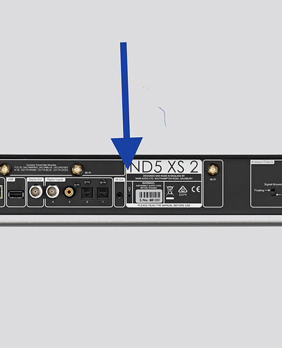

To reset it, stick the little pointy thing that came with the player in the hole on the back. Make sure you feel a click before removing it. The pointy thing that comes with an iPhone is the same.
