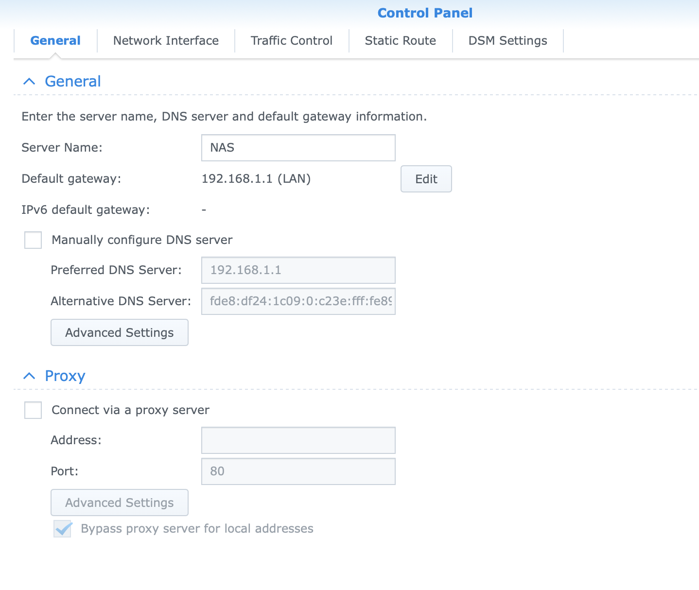

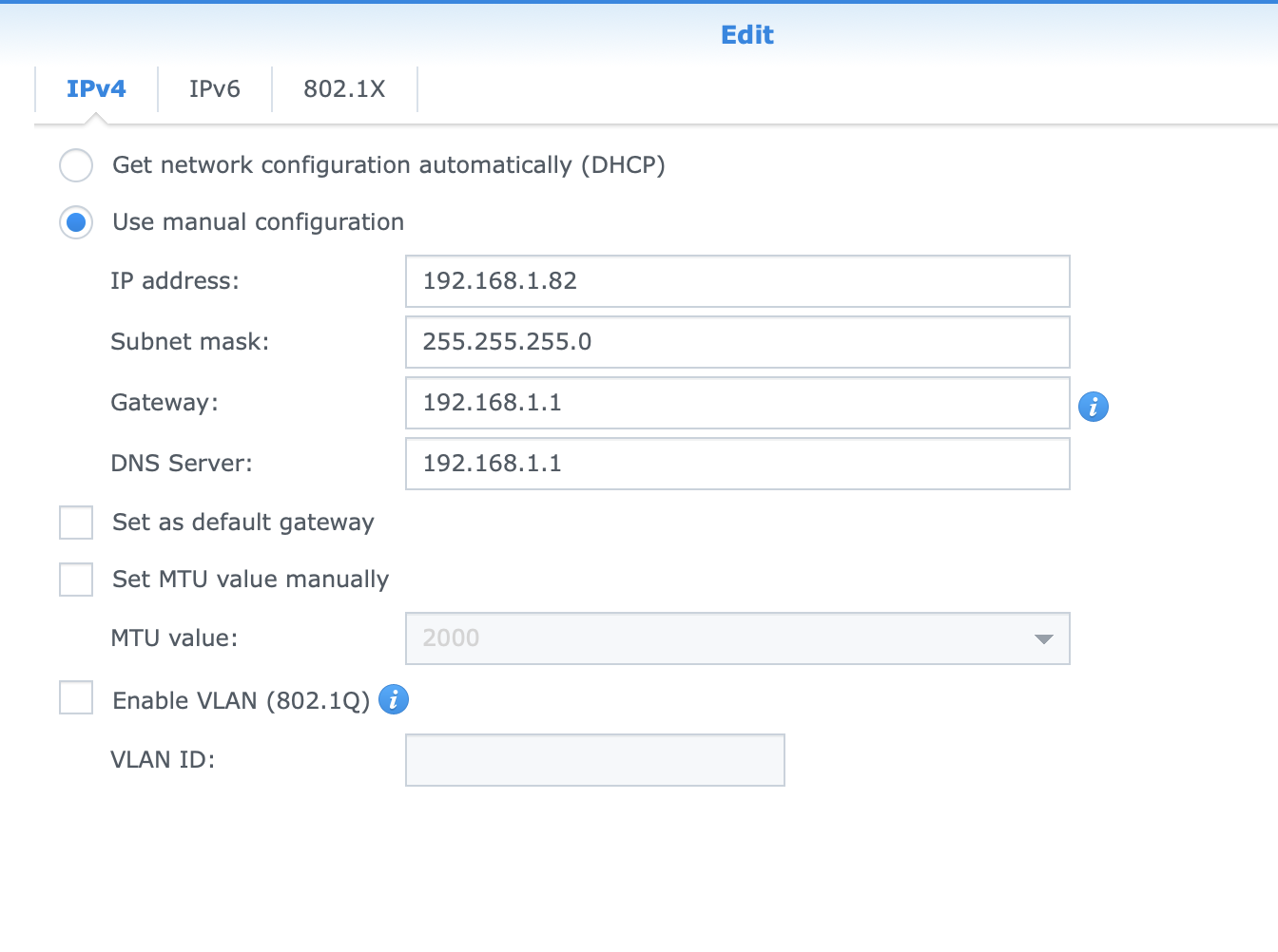

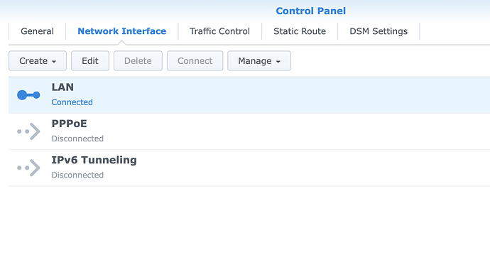

No, I have the Vodafone wifi turned off. It provides internet connection to Orbi via ethernet. The entire wifi network is provided by the Orbi mesh satellites.
The vodafone is set as a DHCPv4 Server
The Orbi is set to obtain IP addresses dynamically from the ISP

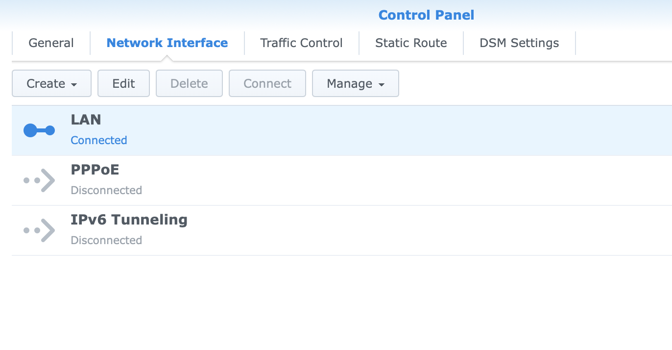

The Synology NAS has the DHCP server disabled. PPPoE and IPv6 Tunneling are both disabled.

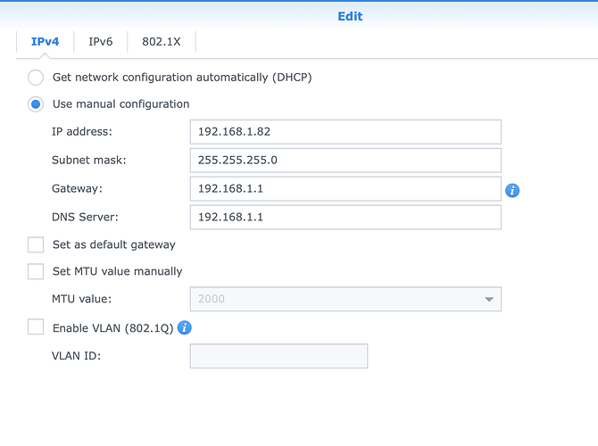

IPv4 was set to automatic network configuration, which I changed to manual (see screen shot).

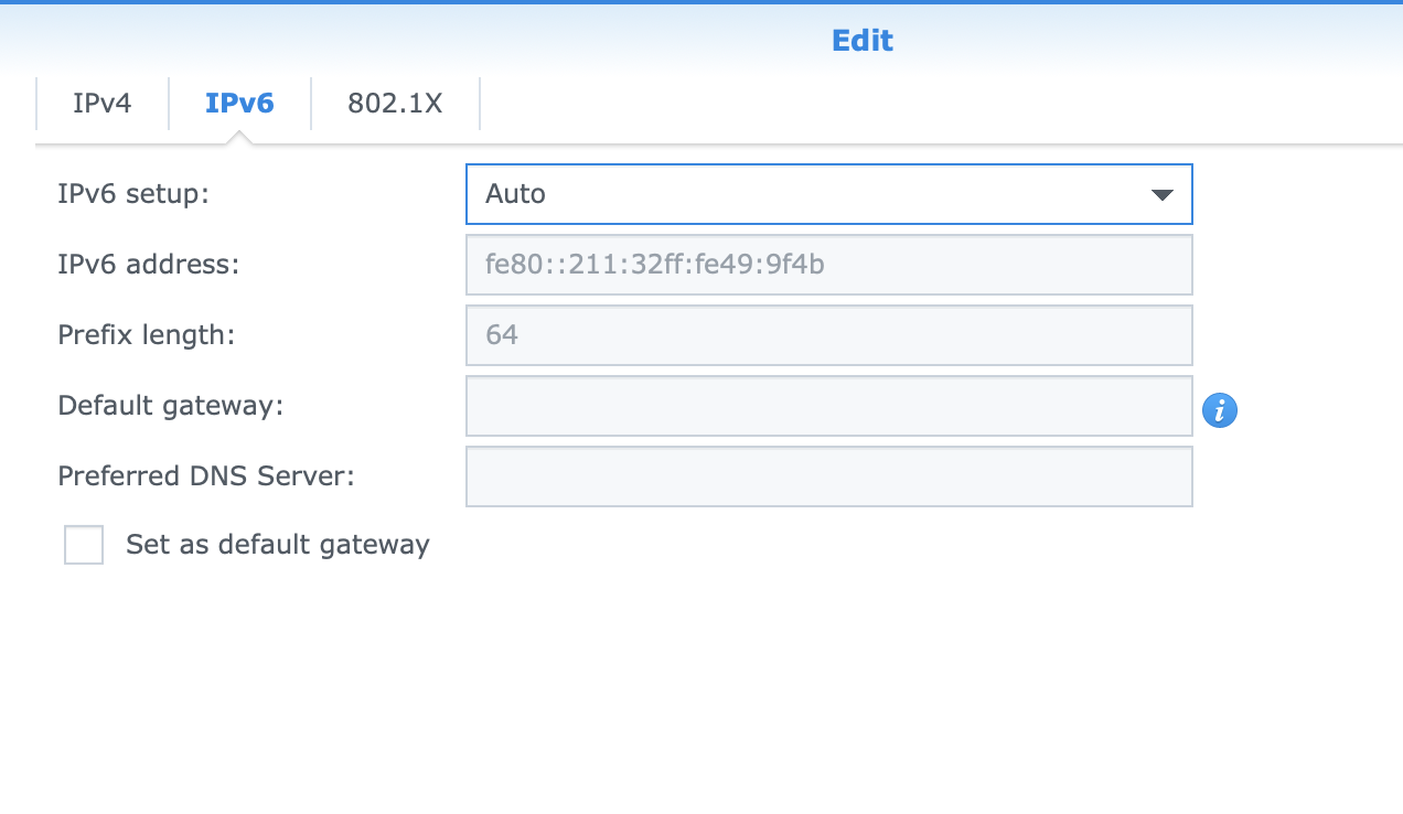

Should the IPv6 bet set to off or manual instead of automatic (see screen shot).
Thanks

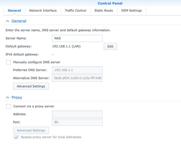

Re Synology, I don’t have “Alternative DNS Server” IPv6 enabled
