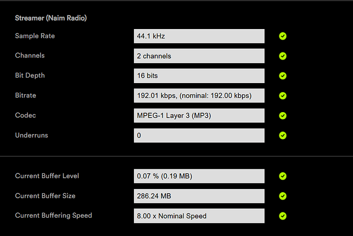

re: Cream, NL - now with full extended metadata :slight_smile: Just checked it (on a CI102) and typical buffer level is quite low as they don’t buffer much server side.- about 8secs worth buffered. Should ride over most internet events though.

Thanks a lot for the explanation. It’s so nice to have someone from Naim with so much knowledge here to help us with questions and information. There is indeed a considerable difference between CREAM and NPO Soul & Jazz (that I used to listen a lot to before it stopped) with regard to buffering. I asked CREAM if they are thinking about higher bit-rates, but no answer yet. Still it is amazing how good it sounds on my ND5XS2 :slight_smile:
