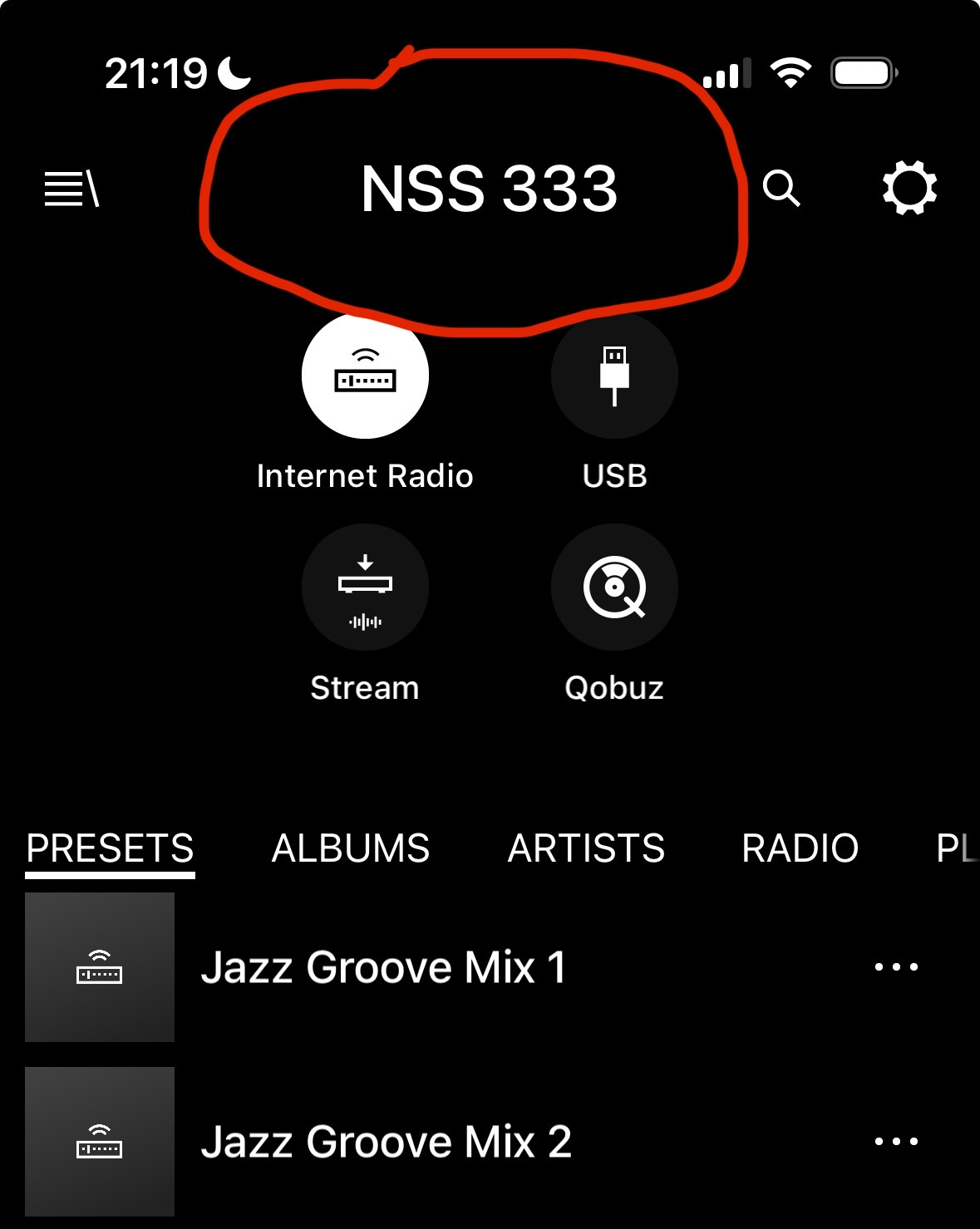

Also press up here. Hidden menu and see if you find NDS there.
