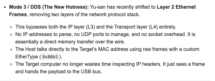

From the Diretta site:
The L1 to L7 refer to the OSI Network Layer Model, and shows they do actually use IPv6 for initial session establish/authentication and then drop down to L3 for end to end data between Diretta systems. So they don’t touch the physical cabling (L1) or raw ethernet frames (L2) as touching either of those would stop initial use of IPv6 at L3.
