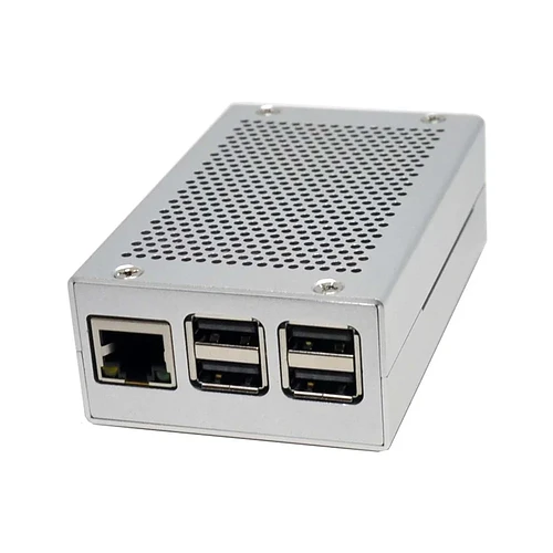

The only problem is that the SonoreUPnP has been unavailable for some time. Another option is a RaspberryPi running RooUPnP. Works the same at a lower cost but some configuration necessary (step-by-step instructions available).
Hi, You are mixing up the ‘SonoreUPnP Bridge appliance’ that Small Green Computers use to offer, which was a RPi-based unit, just running SonicOrbiterOS with only the SonoreUPnP application running. Then this hasn’t been available to purchase for some time, since RPis were difficult to get hold of.
However, the SonoreUPnP Bridge is actually an application/package within the SonicOrbiterOS, which every Sonore Rendu product uses, plus also the SonicTransporter range from Small Green Computer, which can also run the Roon Server and also store local content etc.
I personally run SonoreUPnP on a UltraRendu with a UltraCap LPS 1 power supply, to provide a quiet environment, plus if required I can use this as NAA with a USB output, and a USB→S/PDIF converter. Though I prefer the SQ from the SonoreUPnP route over the S/PDIF digital.
I believe that RooUPnP can also provide the Bridge between Roon and UPnP and therefore offer an option for NDS users, who wish to use Roon - but I have no experience of this.
