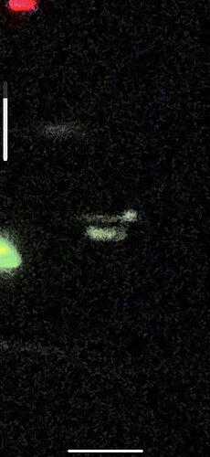

You hold the phone in camera mode in front of the screen and look through it so to say. Most smartphone cameras today have good sensitivity so they pickup low light levels better than the eye. From a distance this is impossible though so mainly being able to walk through the settings if needed.
