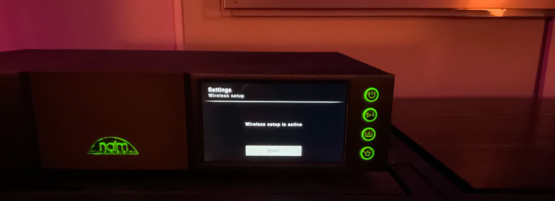

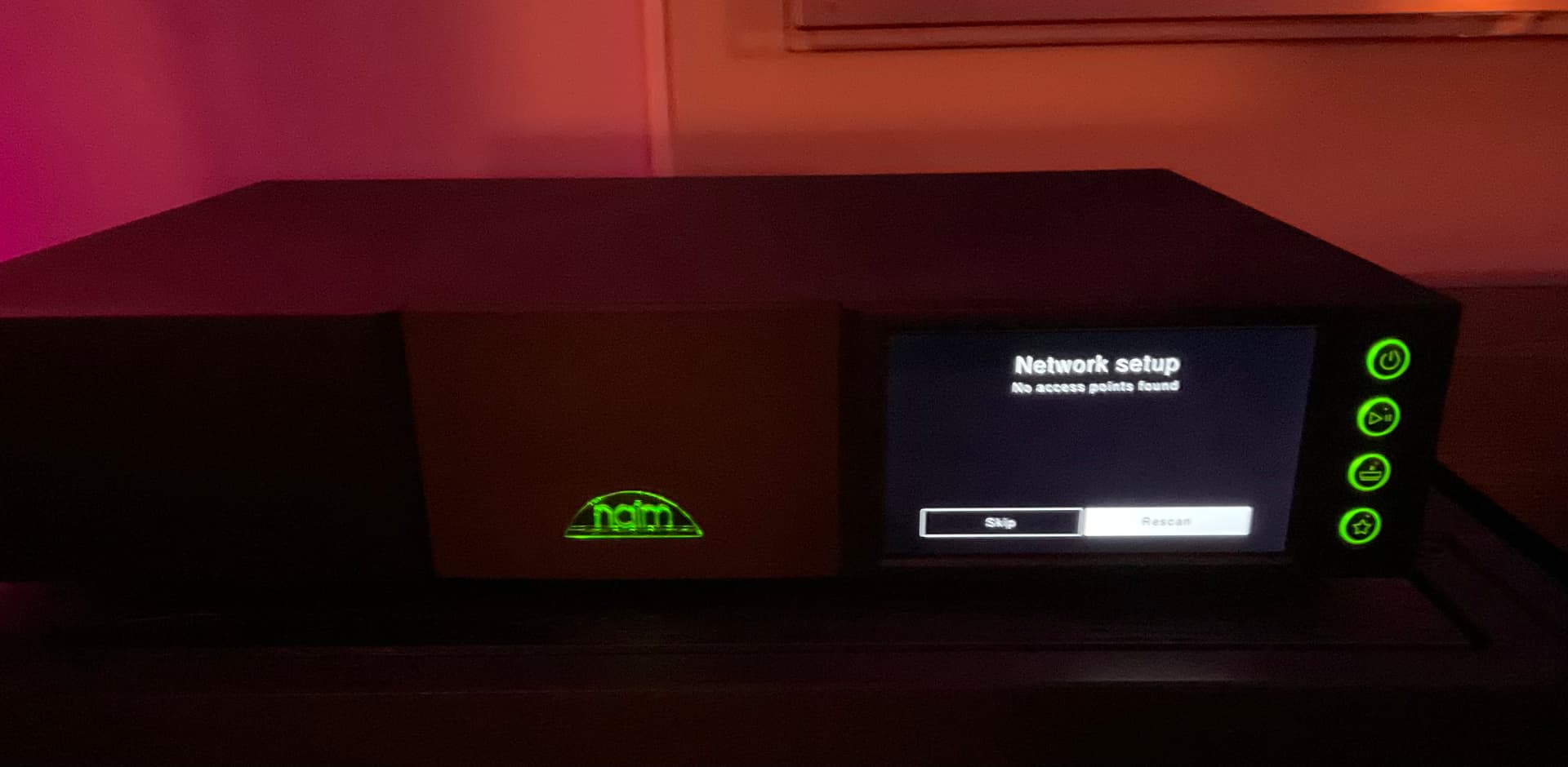

Tried today to connect my NDX 2 via Wi Fi and for my surprise the Wi-Fi does not work,it does not find any network, simply does not work.
Also trying to reset with the menu settings the unit crashes.

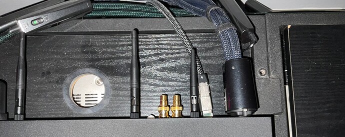

Daft question, but I’m assuming you’ve got the Wi-Fi antennas connected ?
Yes, with no antenas makes no sense.

I’d be more concerned about the strain on those cables than I would be wuth dust.

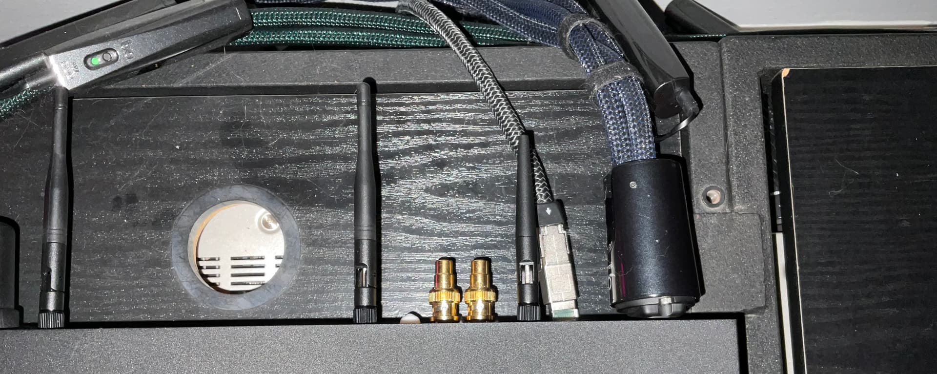

If the ethernet cable is connected, wifi won’t work. The aerials must be vertical and not horizontal. I’d turn the NDX2 off by unplugging it, remove the ethernet, put the aerials vertical, turn it on again and the wifi should work.
As mentioned by Mike above, arrange the leads so they don’t strain the sockets - the ethernet particularly looks as though the cable is twisting the socket, which may break it.

The ethernet was not connected on the photo. I will send the unit to the store and let them view if it needs service.
Yes but, as others have observed, that’s quite a strain on the visible cables.
Longer cables will arrive this week, they will arrive in the same day the NDX 2 will go unfortunately.
