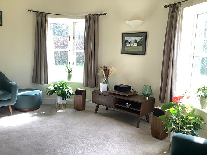

I have a pair of Iotas, and although the top of the box in the Alpha is similar, the bottom is obvs different.
In my auditioning and everyday use, I’ve found that Neats tend to ‘come alive’ at louder volumes. In my office, they don’t normally get to a level where they perform their best, however in the lounge - where I can crank them up - they are a lovely and energetic speaker. Not the most detailed or transparent as others have said, but they for sure have a certain charm.
Short story is: room matters a lot for these. Home demo is highly advisable.

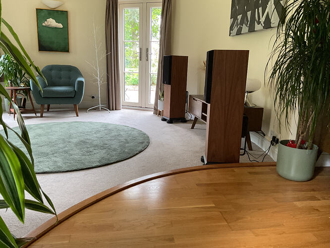

Thanks for taking the trouble to post that, Gary. Your new set-up looks great, btw.
My lounge as actually quite small at 14x14 ft plus the bay window. I don’t think I’d need to drive the Atom very hard so that’s a plus. Anyway, as you say a home demo is the order of the day.
