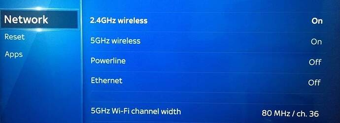

Yes it appears the SkyQ boxes cause network loops with certain types of framing, which by default the Cisco devices (or likely any commercial grade device) will protect you from by disabling the port. Network loops are a bad thing.
Until Sky fix this network bug/issue, the resolution is to use one access type on the Sky Q only and disable the rest. Ie powerline adapter, Ethernet or wifi.
I disable all accesses on my SkyQ other than Ethernet, and have no loop issues and works fine with my Catalyst switches.

I have multiple Sky Q boxes - but I disable all ports other than ethernet - and I can confirm my Cisco switches don’t detect any loop and shut down the port.

How do I disable the other modes leaving just Ethernet?

weirdly, my Sky Q box doesn’t seem to have the options for Powerline or Ethernet in the service engineers menu - I can turn off both 2.5 and 5 wifi bands, but there’s nothing else there…

I asked Sky about the built in powerline stuff, and they said it was no longer used in their current hardware. You can turn off WiFi without the need for any fancy service engineers menu, but not Ethernet as far as I’m aware - not that you would want to, I would imagine.
Indeed. You can “turn off” ethernet simply by not plugging anything into the socket.

Good, have they brought that into the main menu now on the newer models? The older hardware needed the installers menu to disable which I could never quite understand, otherwise the box kept sending out the wifi SSID beacon needlessly using channel capacity…
Yes, you can easily disable 2.4 and/or 5GHz WiFi in the standard menu on mine, which is nearly 3 years old now.
wifi off is still in service menu settings. Just on mime, power line and ethernet disappeared…
Ok, yes I got mine not long after SkyQ came out. My hardware version is 32B062
actually, just went into my installer menu, and I see under network; Ethernet and powerline enablement has gone… just 5G channel width and 2.4 G and 5G enablement. So I assume changed in a software update…
