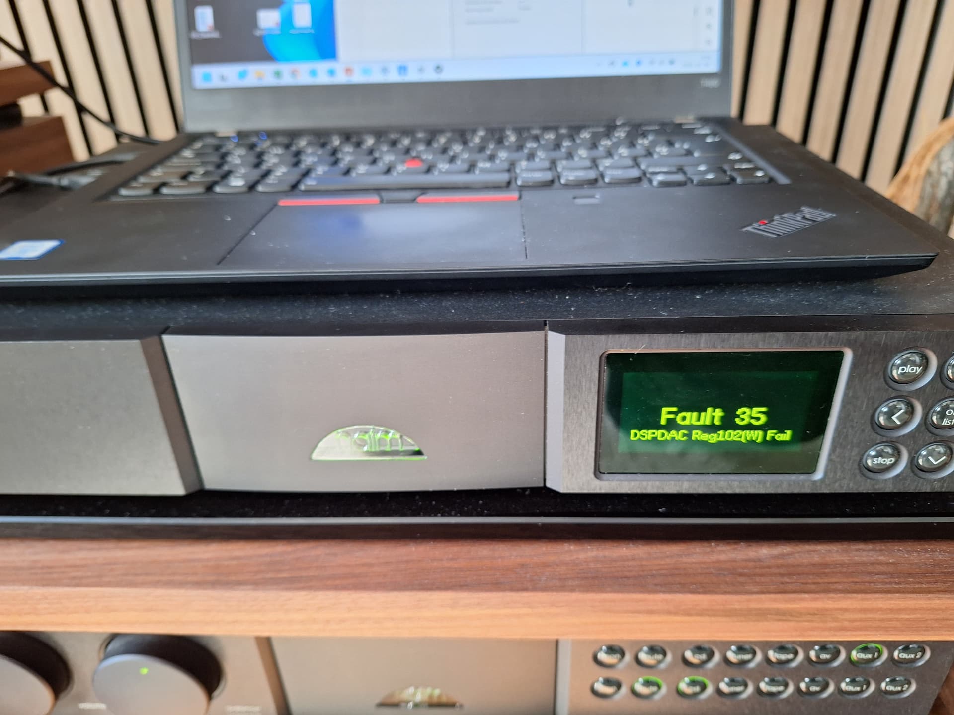

It is faled.
What can I do?
Please help I do not want a garbage from the streamer.
I would suggest that you just restart the streamer they try the update again.
If the update fails consistently you may need to get Naim support involved, but after a one-off comms failure there’s every chance that it’ll work next time.

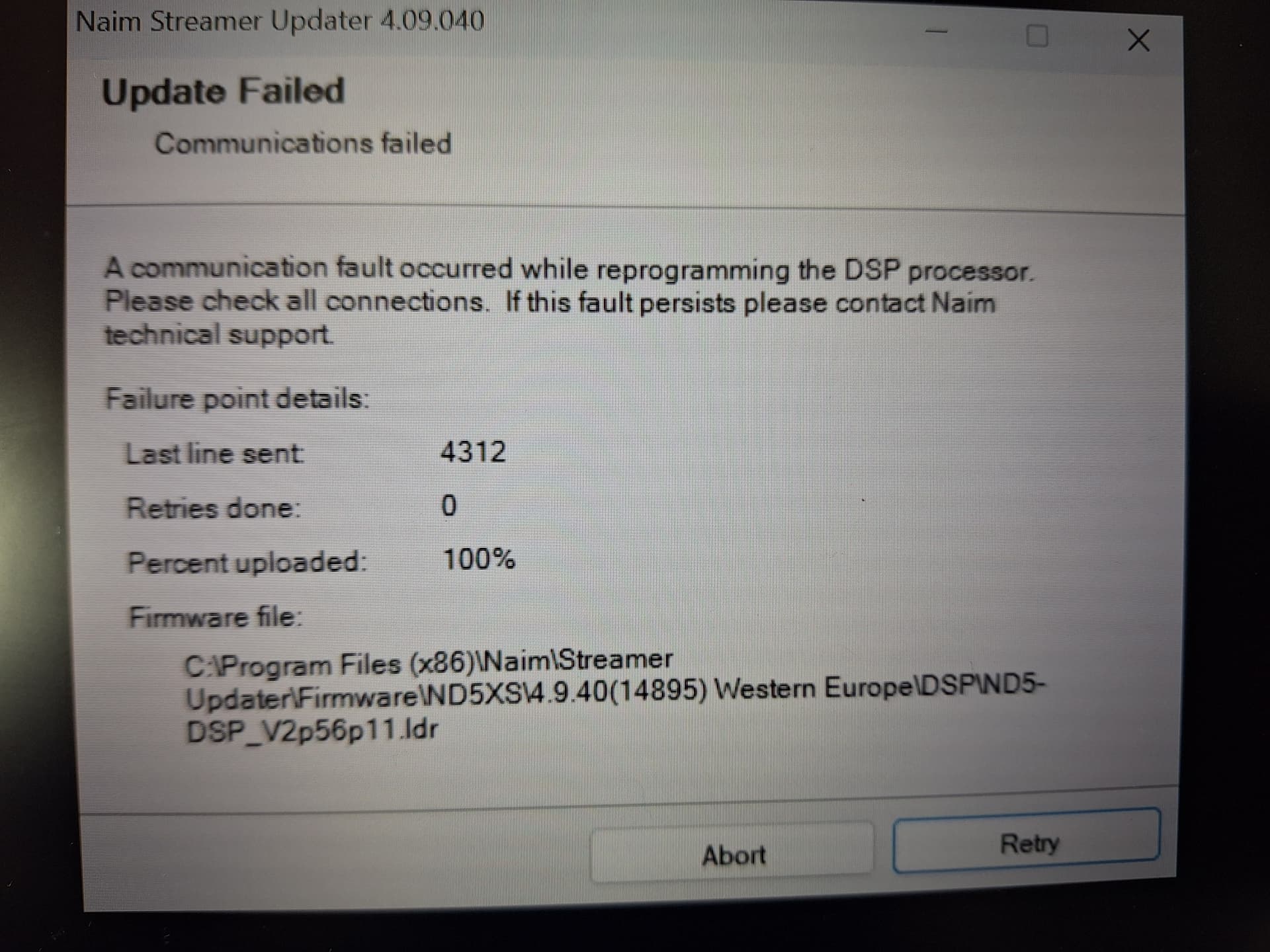

On another thread a chap had the same error. The fix was to start the process again but this time right click the installation file and run as administrator.

Yep, but there the guy can not reach the fw file… please check my and him screen difference.
In my process can not write the processor.

Happens what need to happen… i’ll try to restart the process.
It swung over the problematic point…
I do not know what was the solution exactly.
I …
- restarted the stramer
- Aborted the update program
- Turned off the defender and nod32
- Started the updater program as admin.
- Started the process (no avail at beginning the updater said 4.9 fw is on the streamer)
Ended correctly
