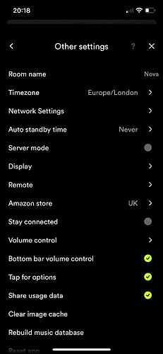

So Roger if you now go back to settings, it should look something like this?

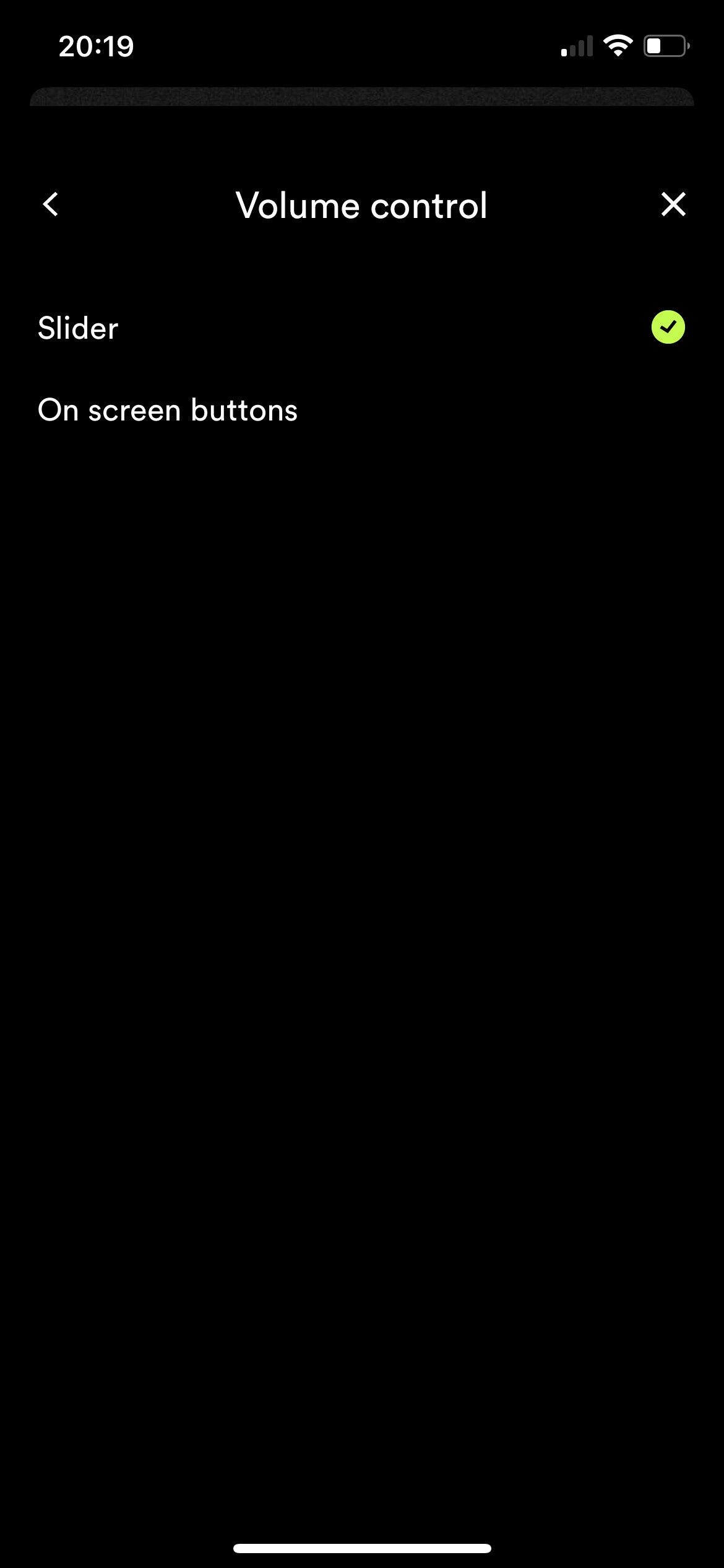

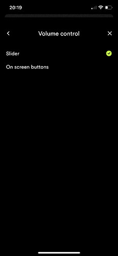

And if you tap volume control, it should take you to this screen..
What are you now seeing?
This is a Nova but I think your streamer should be similar.
When you tapped “reset app”, that is what it did. So now you have to put all your app settings back as they should be. But it’s no big deal.
