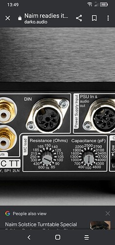

This argument that the cartridge can’t be changed because the solstice is a packaged system is nonsense.
The packaged system contains a phono stage that allows adjustment to accommodate a vast number of cartridges.
So the phono stage is flexible, but the arm isn’t.
