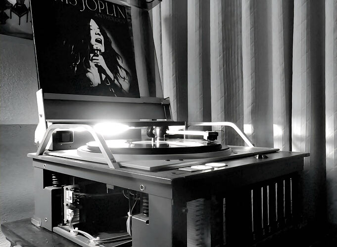

Turntable, a EMT948. ( might get a JC Verdier La Platine soon).

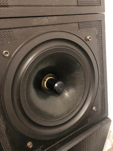

My question to the experts is. What do I have to look in the SBLs has age problems that I have to be concerned? The silicone sealing? Maybe the inside wool? Crossover issues? (Most probably I’ll send to a technician to check crossover and the driver units).

So curious to listen with the EMT948.

I would also add that there’s a gasket between the mid and bottom boxes that may need replacing. Tom Tom Audio used to have these along with the foam rubber grilles that Velcro to the front of the cabinet.
Just confirmed. From what i gather SN under 109.000 are Mark1. The ones I have an eye the SN is 75 thousand something. So mark 1s. I thinking in paying a visit to this owner this next weekend.
Do you know where I can get a second pair of the Woofers? From what i know, Naim stop producing them.
You can keep an eye out for another pair! Do you have a picture of the sbls . Many were upgraded to mark 2 woofers. It they have a lip round the edge they are mark 1. It they are flat then mark 2. I think naim credo used same drivers.
I’d not worry much whether its mk1 or mk2. To my knowledge only rear cabinet color and bas-unit is difference (if not upgraded) Cared cabinet is mandatory for me if I was a buyer. Of course working order..
The biggest issue is often the X-over which need attention and service, money well spend.
Then there’s the sealing described above.
Buying an extra donor pair SBL is always a good idea to secure bas- or tweeter unit spares, otherwise bas-units rare as hens teeth.
Yes, Naim used what was basically the same mid/bass driver - built by Naim themselves - in the Credo, Allae, SBL (Mk2), and SL2, and also as bass drivers in the NBL.
The main difference was in selection criteria and matching - the selection of SBL and SL2 drivers being tighter and the drivers being matched pairs.
