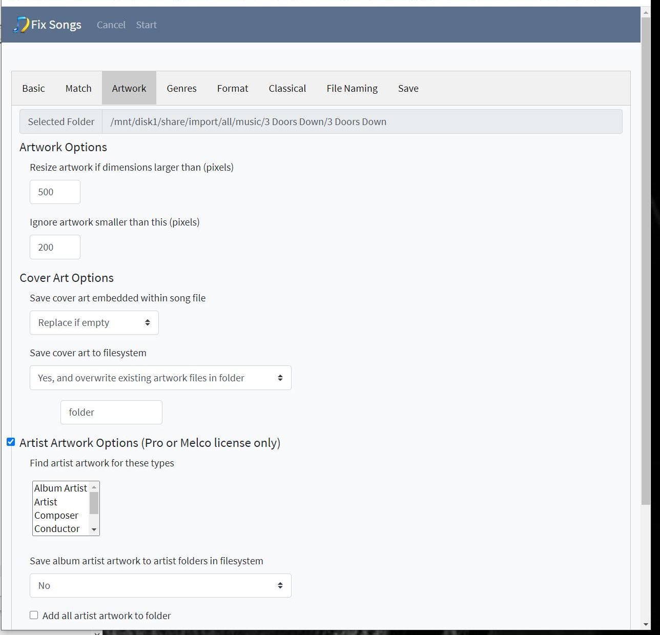

Further to an earlier thread on looking at Melco in my system, I found some seemingly rare ex-dem Melco stuff in black and so went for it. So I now have an N10, S100and D100 with AQ cables. It’s set up and sounding good, (“better” than the N1 one-box I tried), but I seem to have an issue with Songkong. I installed Songkong and MinimServer as recommended in the Melco leaflet, as the Artwork was mostly wrong in the initial rips, using the pre-loaded Twonky, I guess. However, when running Fix Songs in SongKong, while the Artwork was corrected well, every track of every album lost its title and just became “Modifed or deleted item” and could not be played at all. Switching off Songkong but keeping MinimServer kept the correct Artwork and reinstated the track titles/made them playable, albeit with a few inconsistencies in listings on multi-CD special editions. This is using the Naim App as the control App for the ND555 and the Melco as a Server.
What am I not doing/doing wrongly with Songkong, and/or are there compatibility issues with the Naim App?

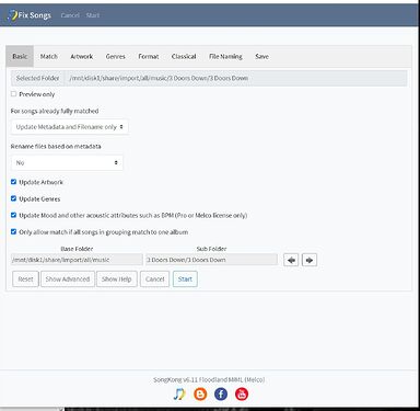

I have n10 running songkong and minimserver 2. Works seamlessly. If you run songkong in preview mode, you can see the changes that it will make to any meta data before you run it for real. In songkong go to tasks, fix songs and tick preview mode box. Run it and then you can inspect the changes it would make
@NB60 Same here, N10 but I run Roon on an external NUC to contol the N10. These are my settings. I’ve never had a problem with SonKong, its great for rock and classical.

Yes, I tried the Songkong preview and the spreadsheet all looks good. It’s just that if I run it, all the tracks change to “deleted/modified” and are inaccessible/won’t play. Will post on the Songkong forum and contact Melco. I had hoped I was just pressing a wrong button or similar…!
