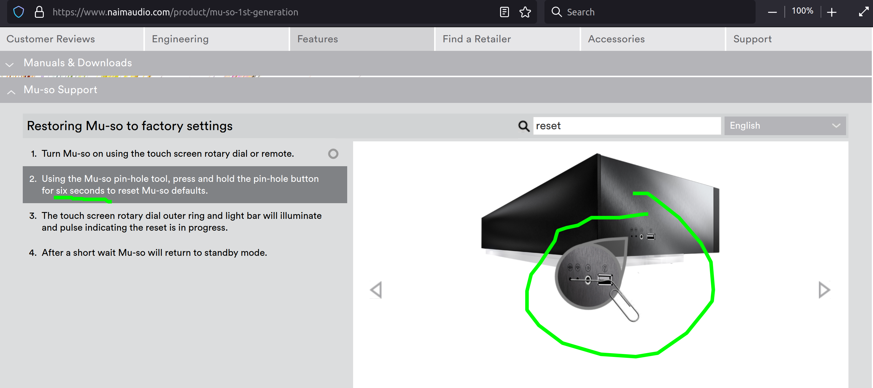

I think your best bet is to reset the muso to factory settings. You do that by pressing in the small reset button, which I think is on the back, with the reset tool provided it with a pin or similar. Press it in for 6 seconds and release. You need the unit powered on when you do this.
There isn’t a reset hole anywhere but the one next to the LED. I’ve pushed a pin in and the system makes no response at all. LED still blue.
So the reset button isn’t the pinhole next to the LED on the side, but at the back?
Probably is the one you mention. I don’t have a muso here, but I don’t think there is more than one.
Did you hold it in long enough? Try longer….
At least six seconds here:
That should have been sufficient
Was it the correct hole?
Yeah, I’ve held it in several times, even for a minute. No change. Blue light stays blue, top dial remains lit apart from 3 segments. Even unplugging the whole machine, and leaving it for a minute, and then plugging it back in just leaves me back where I started
It’s the only hole there is
