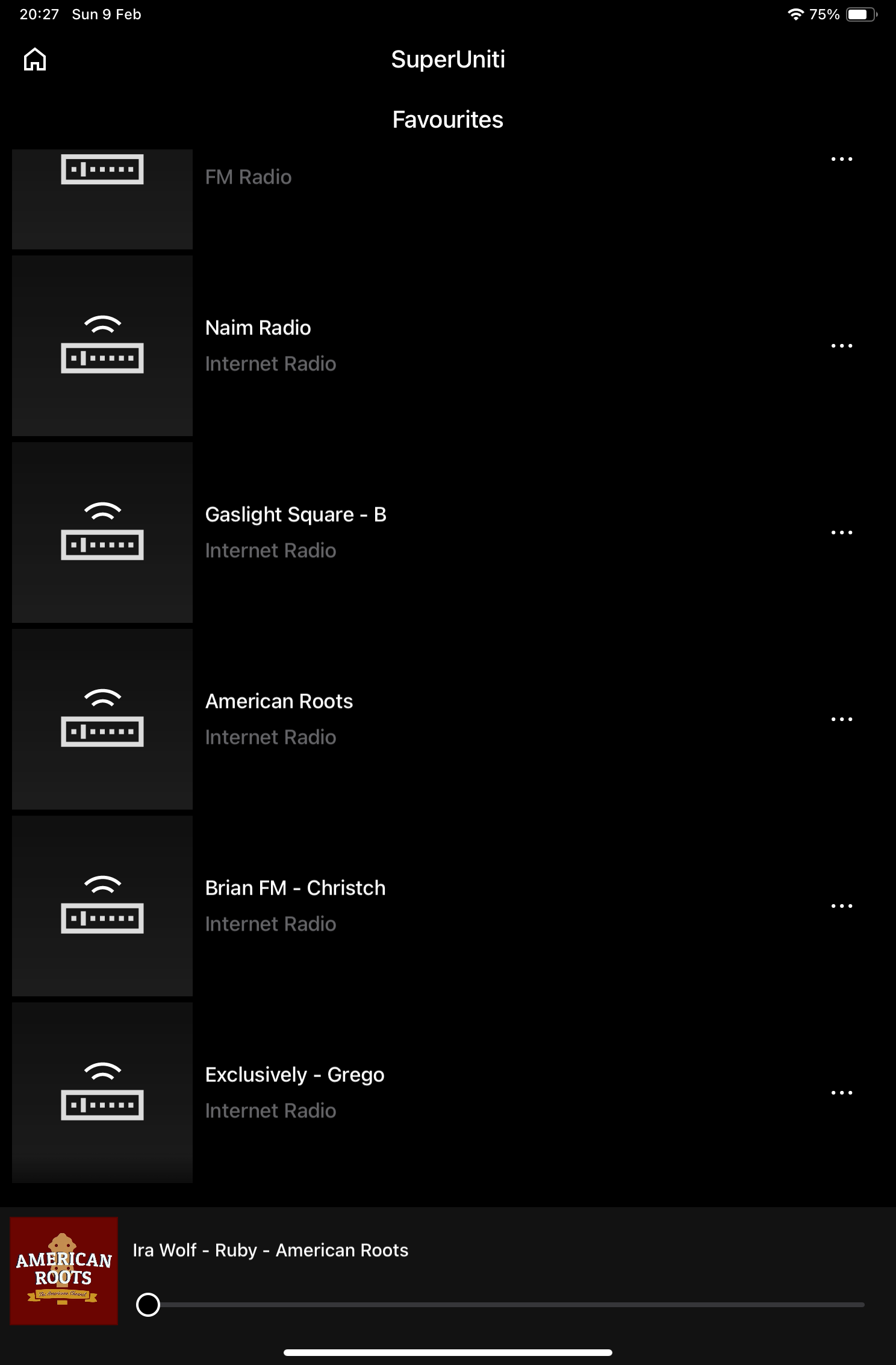

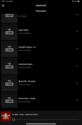

App 7.3 iOS
V4.9 on SU
Adding streams to favs
Can only see one page , if I delete from visible page other saved favs will appear
Regards
Gordon
looks like a later improved screen on your SU. A quirk of it is that it has to be reversed in FW.
Thank you Steve. I was wrong and you are correct. They are the same….thank you for all your hardwork you’ve done. If it was up to me it would be Stevesky MBE.
Further to favs iOS iPad restarted app etc
Connected via android app favs had a visible more button
Expanded that favs showed all saved on android, back on iOS iPad iPhone both now show all favs, maybe SU cache not refreshing after updates old favs deletions adding new in
Regards
Gordon

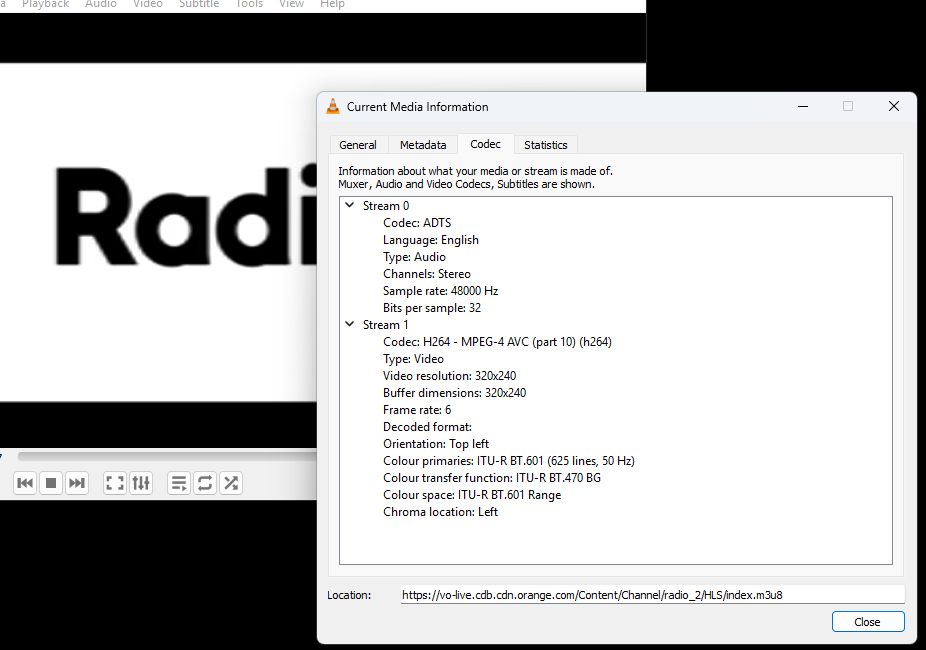

Hello @Stevesky
First I would like to thank you for all your help.
I have downloaded new software to my Mu-so 1 and I find out that Radio 2 UAE is not working. That is strange because on my Mu-so 2 it is working great.
Could you please take a look what is here different that on Mu-so 1 it is not working.
Thank you.
Hi @AlexS82
This station is a bit unusual as it’s actually a video feed (with a static image in it) rather than just an audio feed.
On the newer products like the Muso2 it can handle this stream and demux the audio from the video. On the older products they can’t, so it unfortunately won’t play.
Regards
Steve

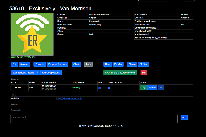

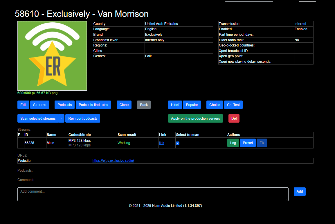

Hi Gordon,
The Exclusively streams are in the UAE. Example:
So International->Middle East->United Arab Emirates->Brands->Exclusively
As a disclaimer we don’t track this network in great detail as stuff is constantly coming and going and it’s not really radio, it’s playlists. If one is missing, let us know and will add it.

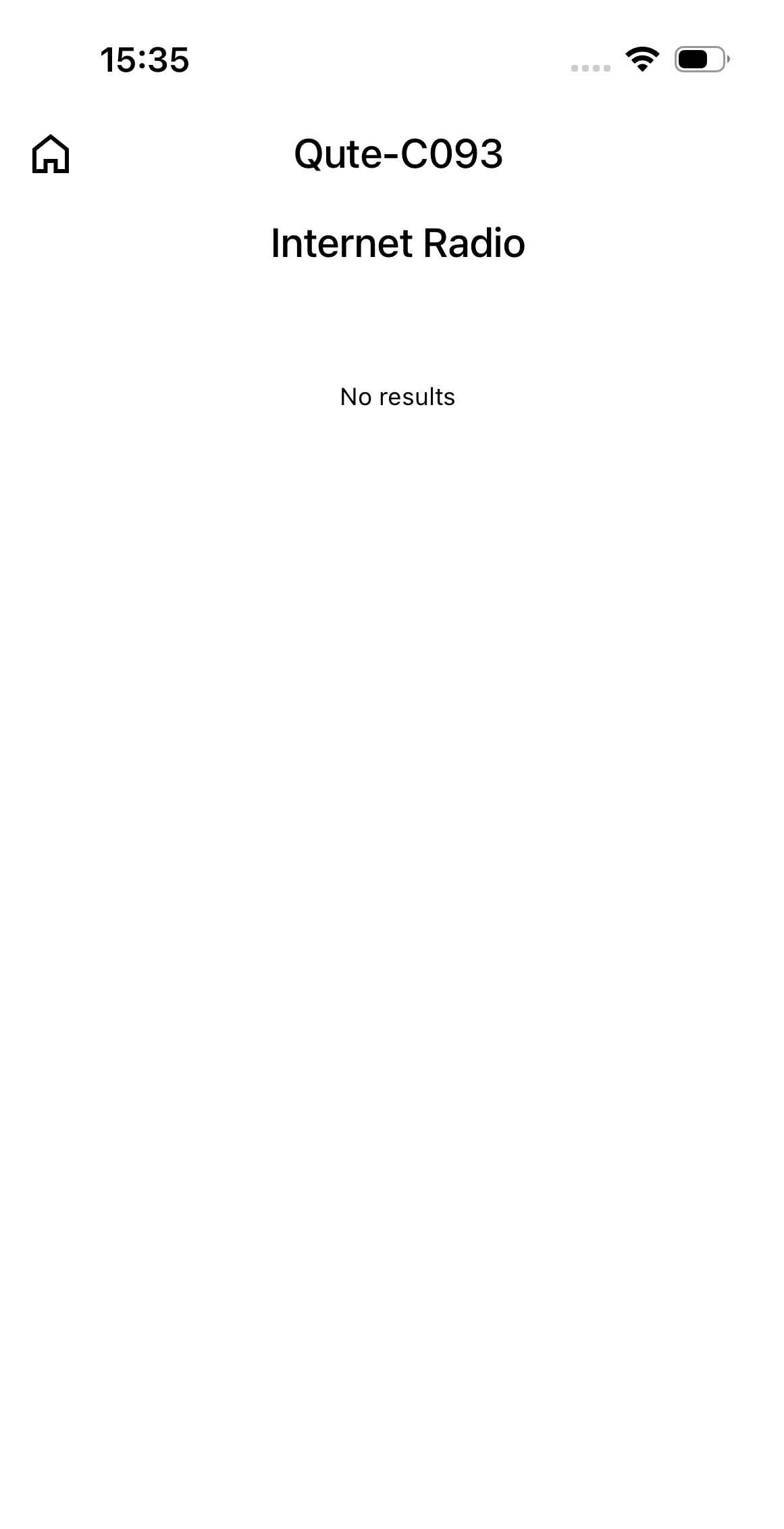

Hi Steve,
I appreciate the older devices have reduced capacity and therefore functionality
In the absence of a search feature how can you find iradio stations and configure the presets.
I have a qute 1, updated to the latest firmware and iradio search returns no results
Thanks
Yep, it seems the only way is via AirPlay. :smiling_face_with_sunglasses:

You need to navigate the iRadio menu and find the station. That usually means that you need to know its geographical location, often by looking on the station web page if you don’t already know where it is.

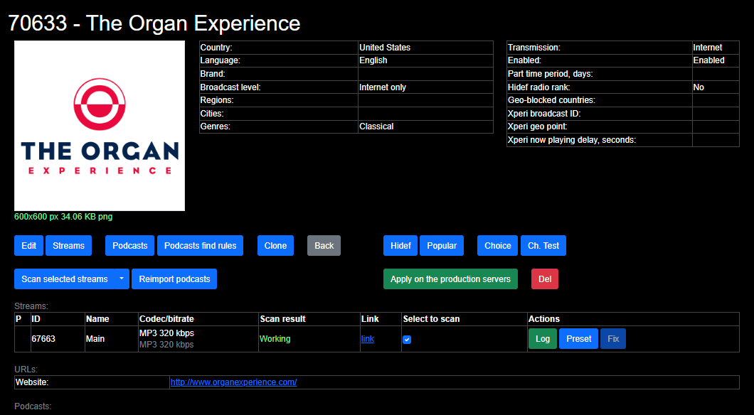

Hi @Yankiwi
re: Organ Experience
Assuming we are talking about this channel:
We have it in the system. see:
However, the channel seems to have an issue as it just has a voice message saying check the playlist for what’s playing, but they forgot the bit of playing organ music.
I’m assuming this maybe some short-term fault on the channel.
Best
Steve

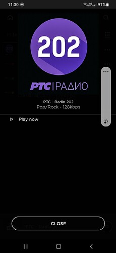

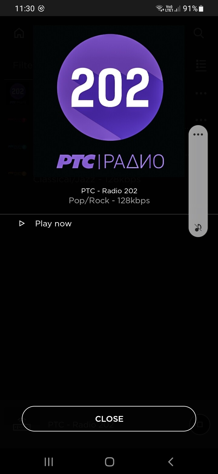

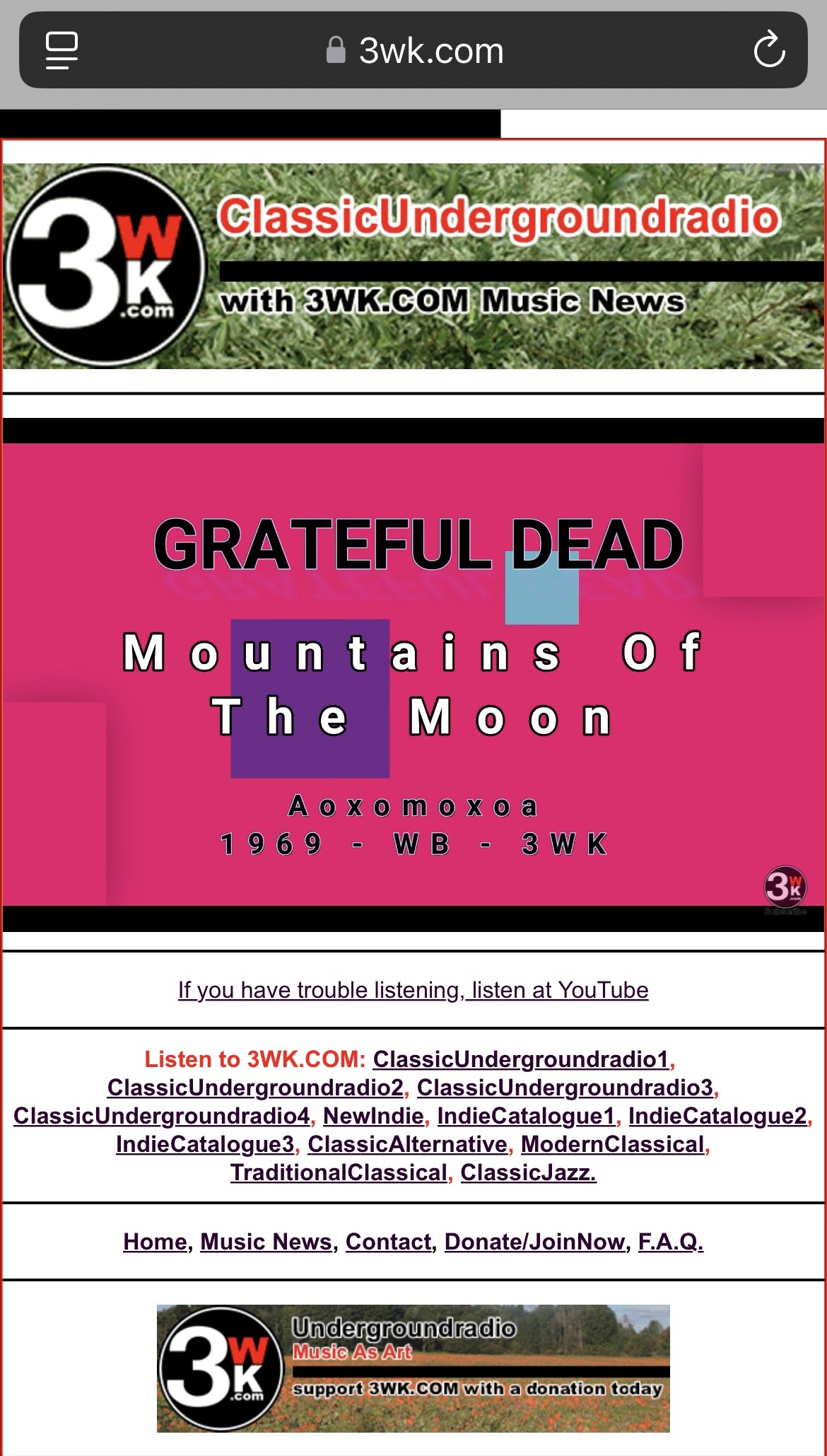

Hi @goranp
That will play on the newer products, but not on the older.
I’ve adjusted the URL to hopefully make it compatible with the older products. Can you try again.
Thxs
Steve
Hi Chris thanks for the suggestion
Unfortunately the search brings back no results
And using the remote to try and navigate doe not feedback to the app.
I was able to successfully use search on my MUSO QB1 and create new presets.
I saw elsewhere that features were disabled on older devices including the search.
I have a tried factory reset, but without a working screen it is not easy.

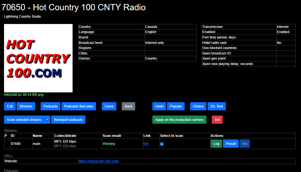

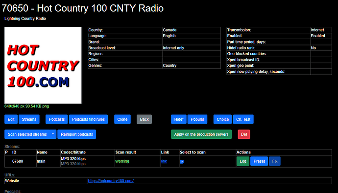

Is is possible to get back Lightning Country Radio, was on A1 Country Radio Network (asking for the wife :wink: ) It appears to be in Canada. Lightning Country CNTY Radio: listen online
Hi @cdgulley
I think this station changed it’s name from Lightning Country Radio to Hot Country 100 CNTY Radio. Their website: https://hotcountry100.com/
Now added to the system:
Best and hope the wife enjoys it… :slight_smile:
