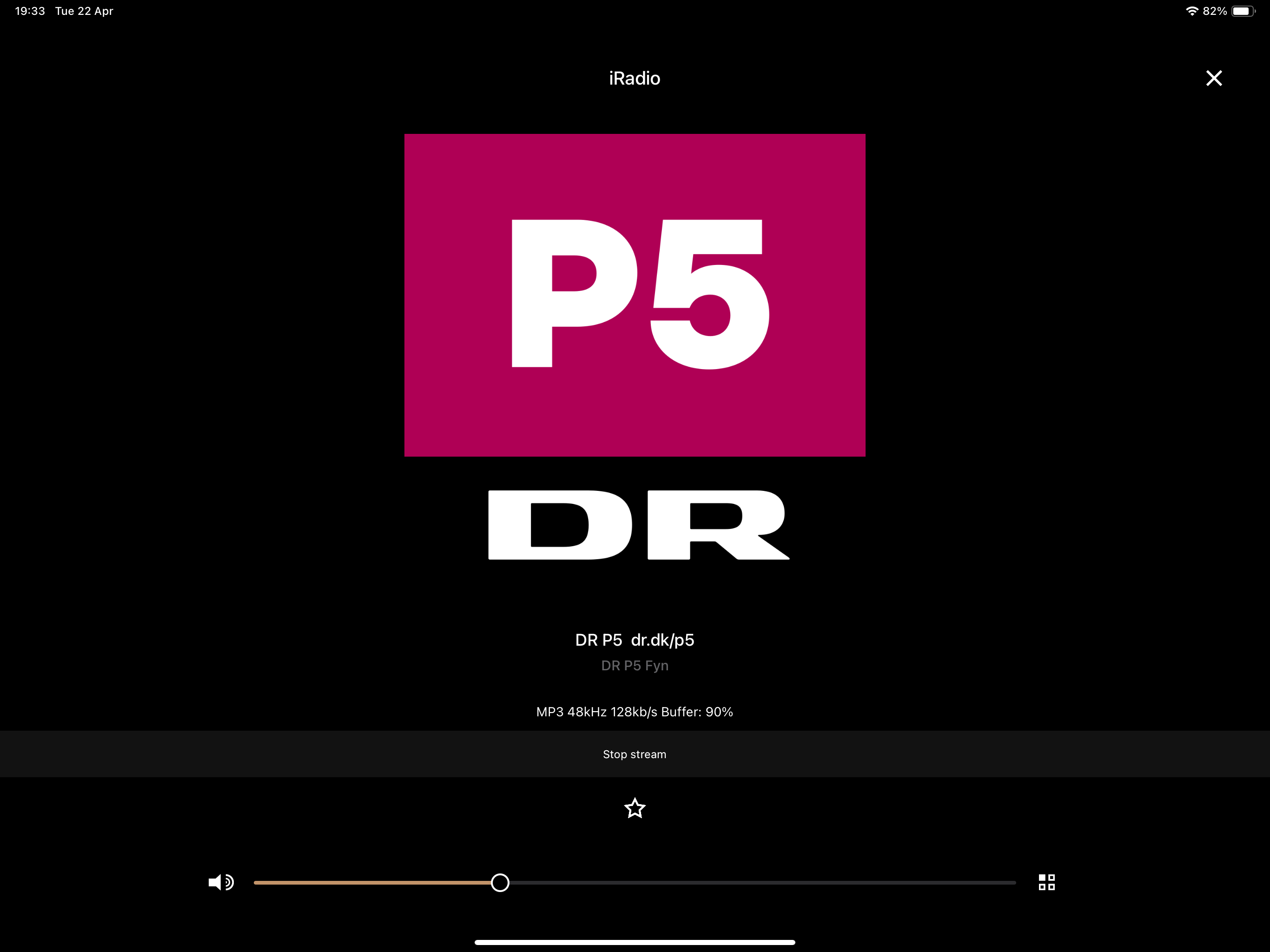

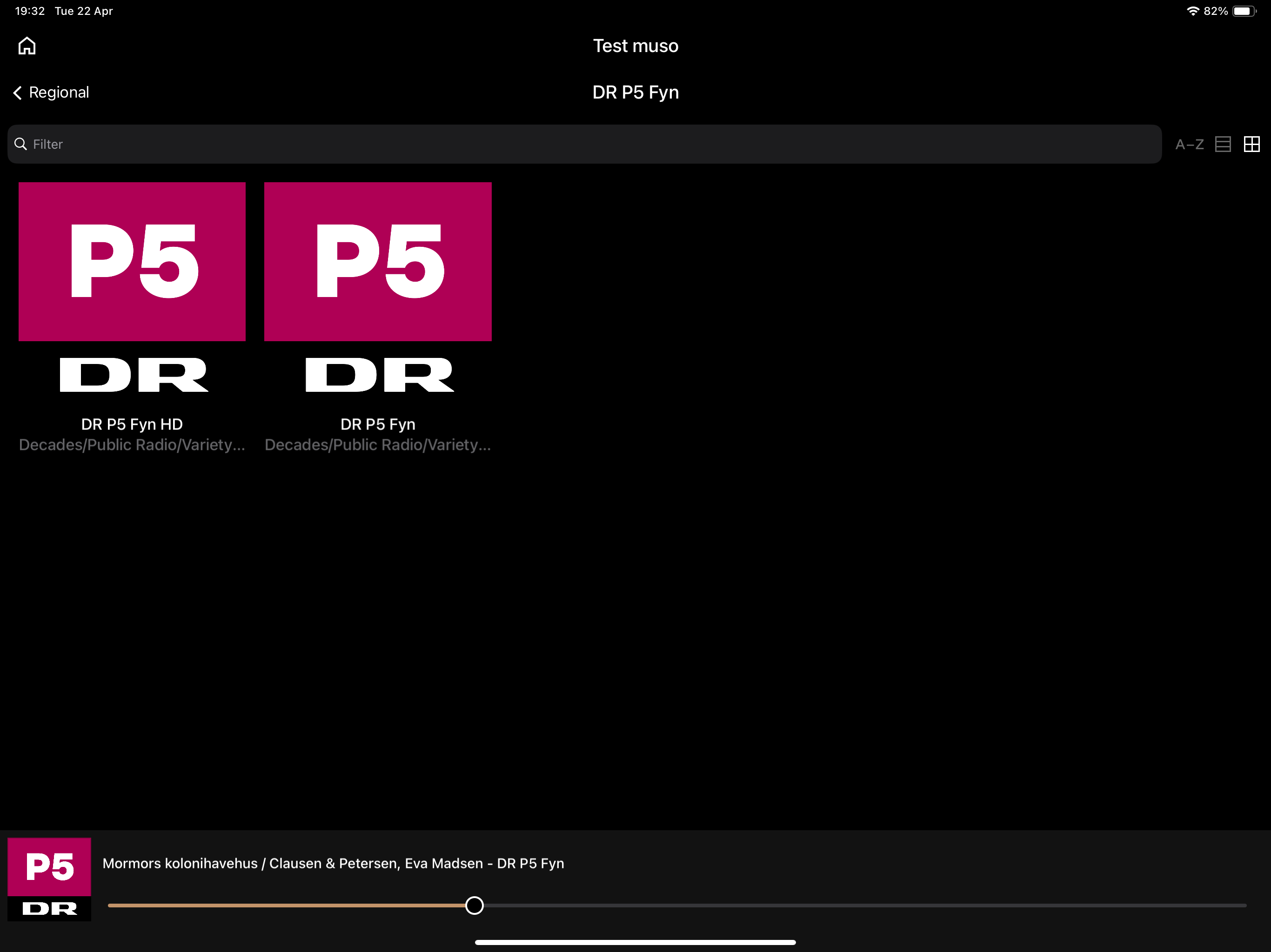

After update to Naim internet radio I have problem listen to Danish national radio P5 there are only the option to select the high bitrate and that is very slow to change canal and falls out now and then(ones a minute). I have fiber internet with 1000Mbit the MU-SU is connectet by wire and the MU-SU QB is running WiFi and is the same on both systems.
Is it possibly for you to make it possibly to select normal bitrate on the Danish national radio P5?
Regards John
Hi @Jojeta
There are various regional P5 stations but they all seem to offer HD and SD.

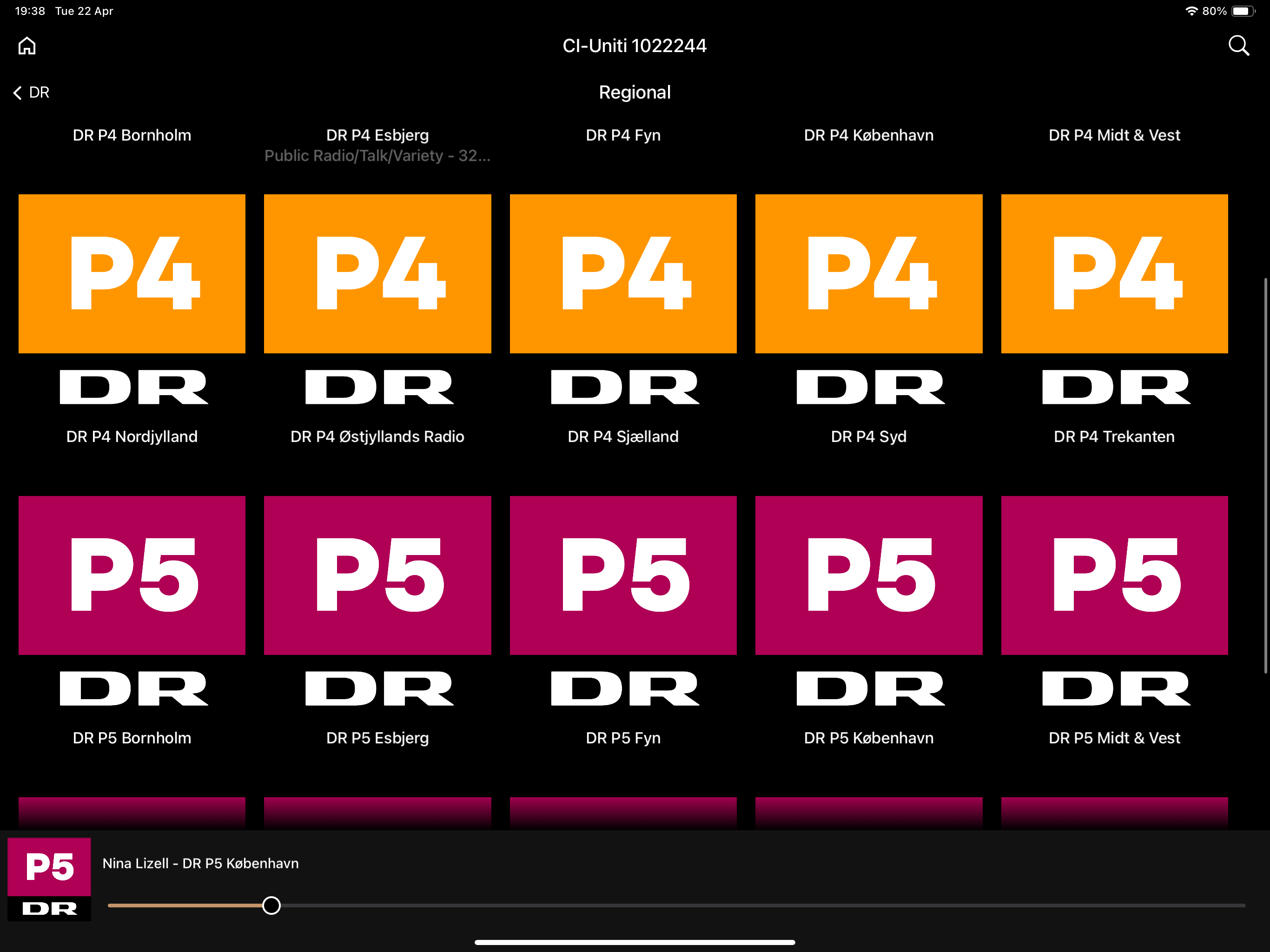

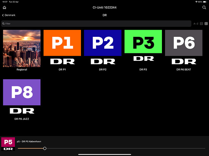

So, if going to the DR public radio view:
Next up pick regional:
Pick one of the P5 regional channels:
Then pick the SD. That shoukd then play the mp3 variant:
If it seems unhappy on the network, suggest remove the power from the Muso, wait 20seconds, plug it back in and see if things are better.
if the views in the app don’t look anything like my examples, terminate the app on the phone and restart it. It might be remembering some history of last browsed of when it was using VTuner.

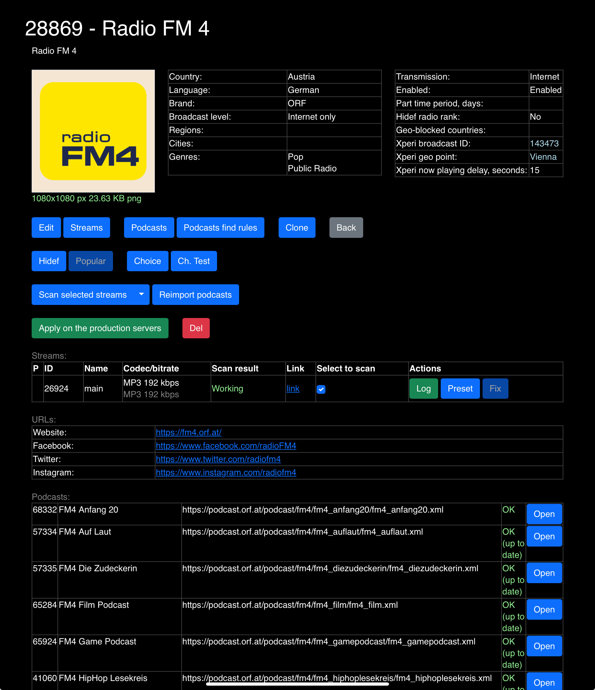

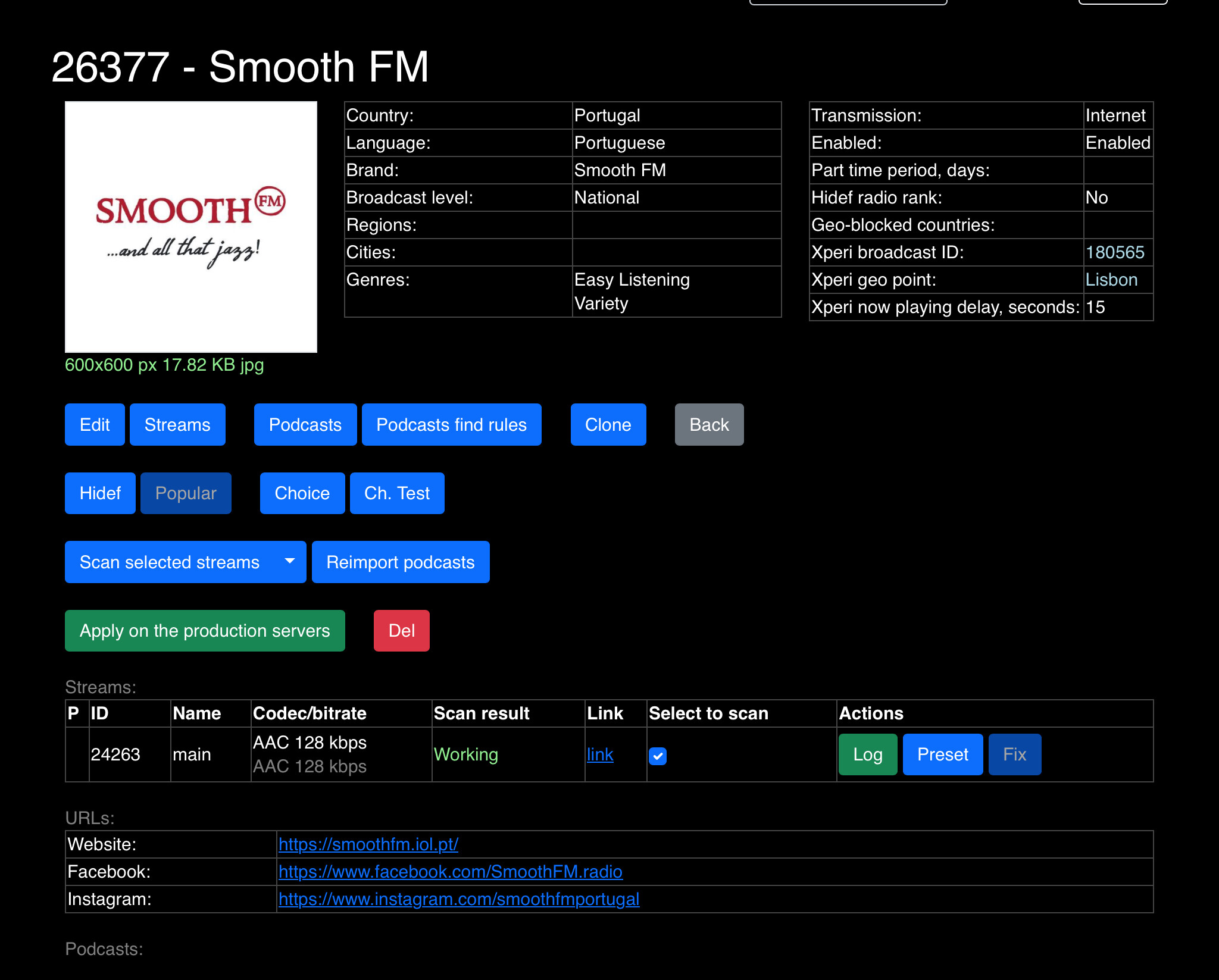

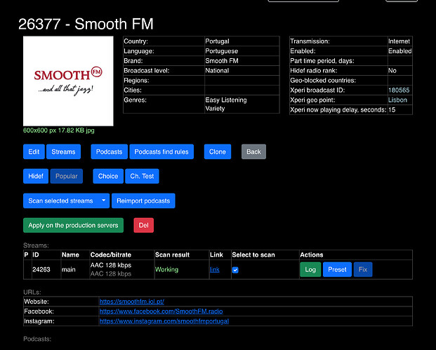

Hello,
I’ve been waiting for a while, hoping my favourite stations would start working again. Since they are still available on vTuner, it seems they have been removed from the Naim station list. Could you please add these two stations back?
—> ORF FM4
—> Smooth FM 103.0
I used to listen to the radio stations every day, so it’s very inconvenient that they’ve been removed. I would appreciate if they return. Thank you!
Hi @yve
We have those stations already:
In International->Europe->Austria->ORF you’ll find Radio FM 4
For Smooth FM 103 I believe you’re referencing to a Portugese station (it no longer broadcasts on 103MHz). We have it here:
Browse to International->Europe->Portugal->Brands->Smooth FM.
The full network for that station is mapped.
Regards
Steve
I note that the artwork metadata is still missing for NDR1 STATIONS. TRACK DATA SHOWS BUT NO ARTWORK. Apogies for shouting, caps lock got stuck!
OK, thanks, Steve.
Thanks for mentioning the tree-based search! I wasn’t able to find these stations using the search field—it seems to be very sensitive to how the station name is saved. That tip was really helpful. Also, many thanks for getting back to me so quickly.
Hi @yve
I’ve extended the search key words for the Radio 4, Austria as it needed a few more vital words to improve its search rank.
The Portuguese Smooth FM one is a tricky one as there are sooo many Smooth FM’s around the world. I had to look back at vtuner to appreciate what their reference was (which is out of date) to resolve it to the Portugal one.
For reference, the search engine prioritises stations in the users country, so searching for ‘Smooth’ in uk and ‘smooth’ in portugal gives different weighted results.
