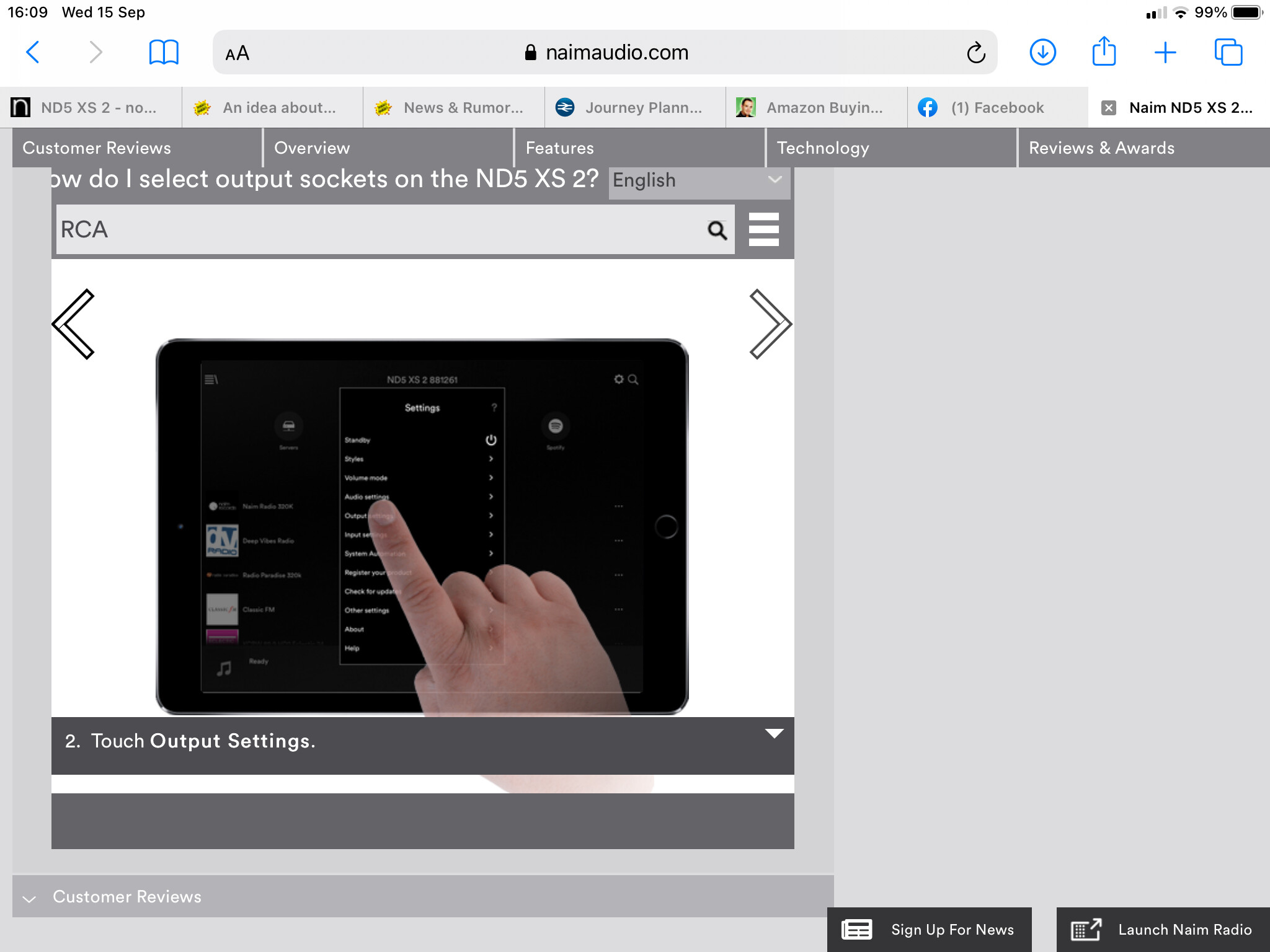

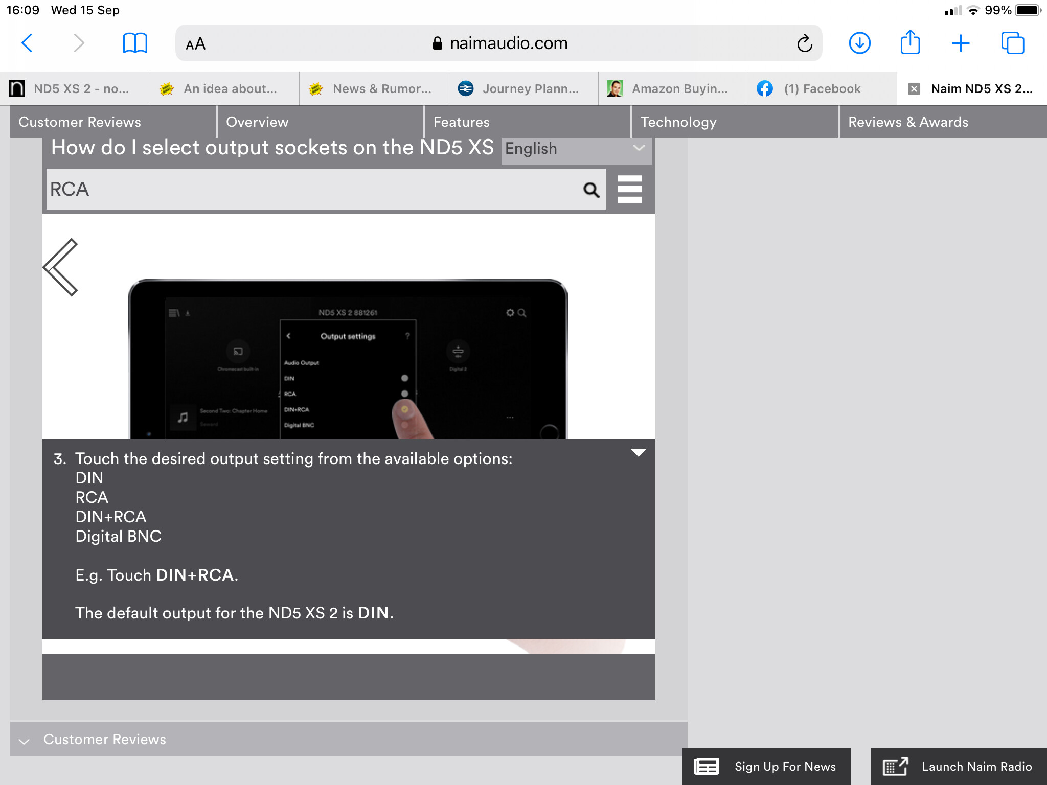

Are you using the DIN or RCA outputs to the pre-amp? Check in the app which is set on. It defaults to DIN.
That was it. In my defense I was returning to this thread to say I’d figured it out. :grinning:

I suspect it has caught out a large number of RCA users.
Maybe mention it in the instructions . . .
