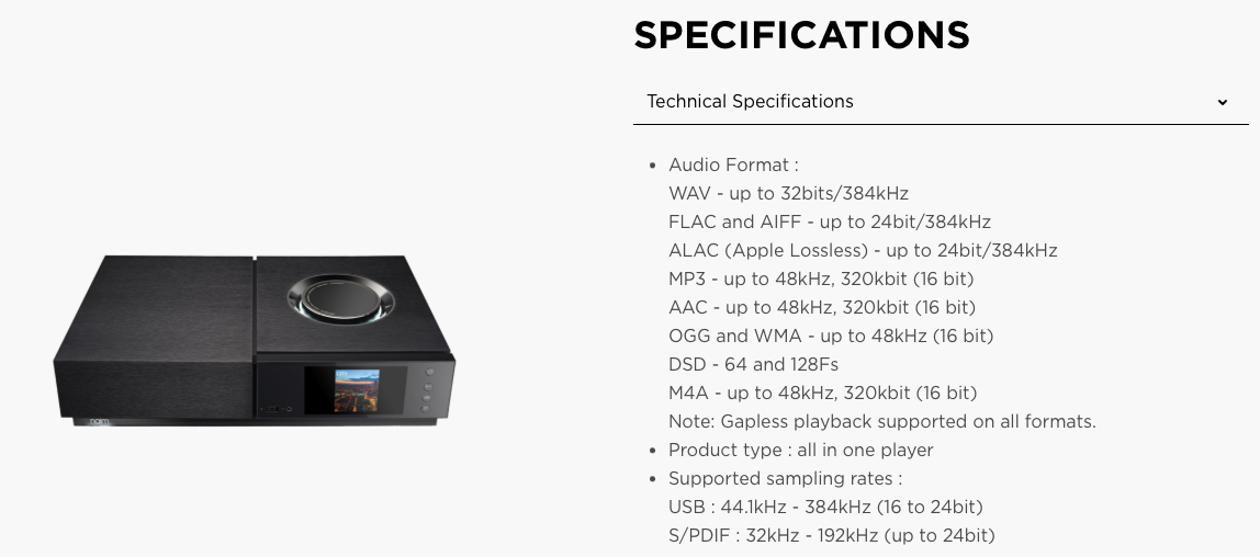

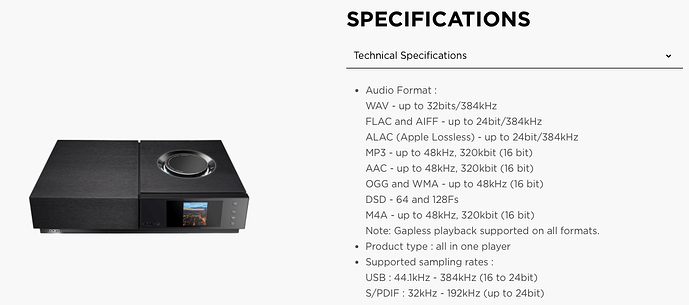

While the DAC chip in itself tells you little, Naim use their SHARC-based digital signal processing, and then a small part of a Burr Brown/TI PCM1791 DAC.
thanks, could you explain what that SHARC-based processing mean?
Which speakers du you use please?
The original white paper for the standalone Naim DAC probably explains it in the best detail;
okay thank you
And what it translates into is great sound and support for most all of the relevant bit rates and sampling frequencies;
