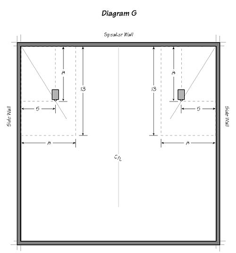

Try to play some music with bass to local bass room mode and see where is the best place for sitting position. Then move the speaker after… acoustic panel can be added later
Setting up in a Square room is not easy but can be done
Cardas positioning for square room. Google will lead you to the full details
