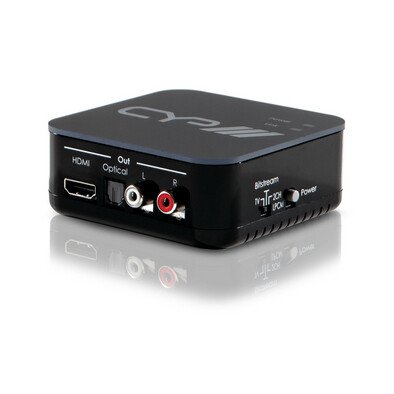

Could you use an HDMI audio de-embedder? That’s what I use to separate the sound out from a ROKU streaming stick. It has outputs for digital or analogue along with the HDMI output. It comes with a wallwart power supply. It works well for me but I don’t have the expertise that others here have to know what its limitations might be in your proposed use case.
The one I bought is made by CYP.

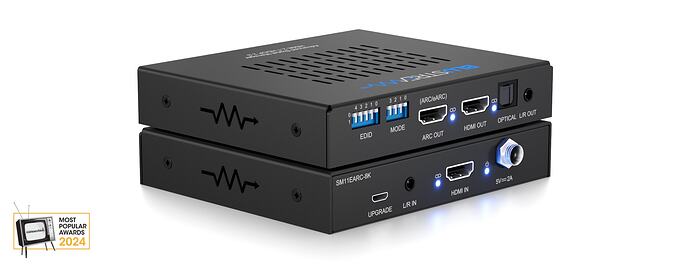

I was in contact today with an audio/video dealer and he also suggested to go with apple TV, a fast HDMI cable and to take this one:
i guess i will check that out and take it from there.

i ended up with an apple tv 4k and this little box: SM11EARC-8K.
it does a good job and insupplyed itbwith a decent power supply, which helps a lot in picture quality.
i believe it is a good setup; so far inam happy with it .
