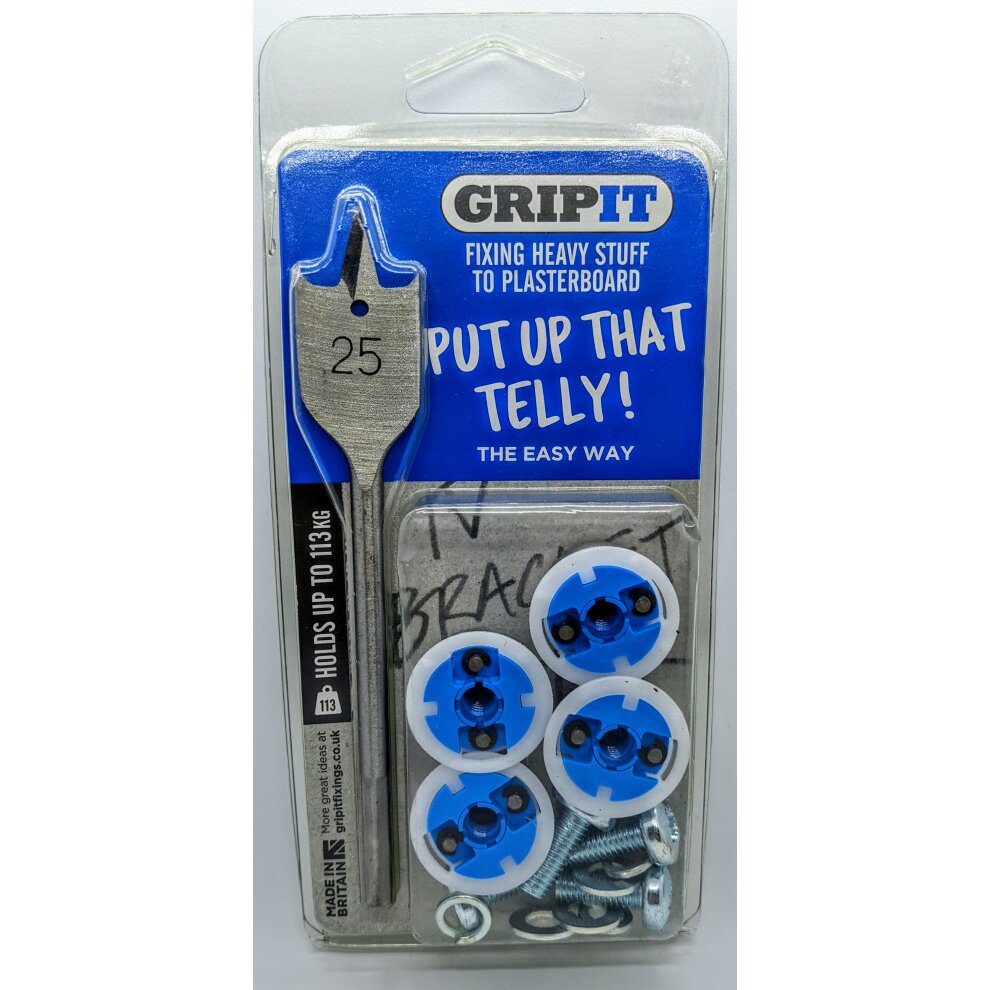

It seems to me the mounts/brackets for bigger tellys are heavier than the screens, well almost, so try these…
I fixed a couple of heavy items, a mirror and a cabinet, using them and they were great.
