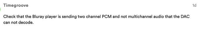

Check that the Bluray player is sending two channel PCM and not multichannel audio that the DAC can not decode.

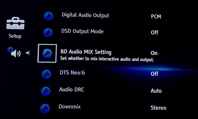

I have the Sony BDP-S5100 and have the digital output fed into my NDX2. These are my audio output settings which may help you

@james_n thanks i have tried the same settings, don’t work with the DAC but worked attached to an AV with the coaxial input for testing. So probably @Timegroove has right: “the output from the Bluray player is not correct for the DAC”
