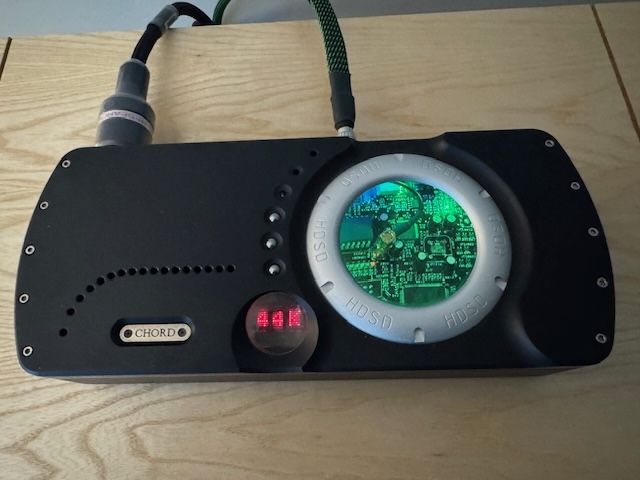

The unit’s display provides diagnostic feedback: after power-up, it should scroll “Chord,” then display the selected input source, phase mode, RAM buffer setting, and finally the input selected. Once a digital signal is locked, the display will briefly show “LOCK” followed by the sample rate (e.g., 44K, 48K, 88K, 96K, 176K, or 192K). If the display shows “LOCK” but no audio is heard, the issue is likely within the output stage or signal path after the digital-to-analog conversion.
The CHORD does exactly what it should as illustrated here, save for the output. I suppose it could well be the DAC.

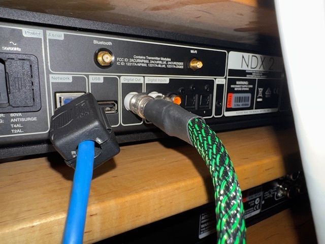

Could we have a photo of your current setup and connections please? A picture is worth a thousand words :slight_smile:

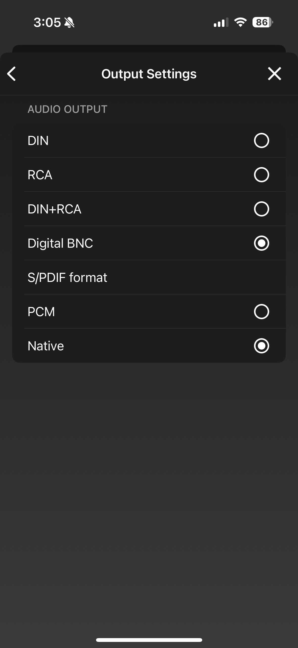

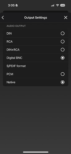

Here are some pics. I have also tried what NigelA10 is saying, connecting a pair of RCAs from the CHORD to the 252, but still nothing, even after reprogramming inputs…
I’m starting to deduce that the RCA inputs on the 252 are possibly the culprit. I have nowhere else to point to.
