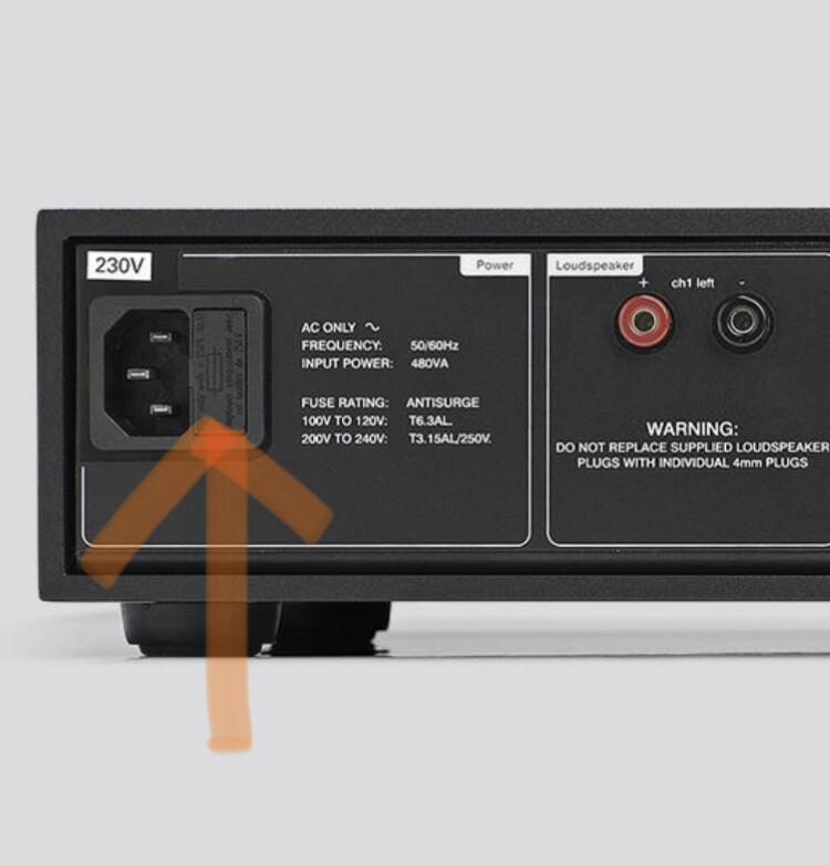

All Naim components have fuses inside as well. Look at the iec socket on the back.

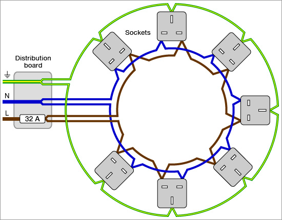

The fuse in a UK power plug is there to protect the flex that links it to the appliance only. The reason for this is that UK domestic wiring uses ring mains that can include quite a large number of outlets, and therefore require a high rated circuit breaker (or fuse in older installations) which it too high to safely protect the individual flex. Thus the additional fuse protection is required.
Other countries generally have different domestic wiring arrangements which do not require these extra fuses, so you won’t see them in US, European and other plugs.

The fuse in the 13A plug protects the cable & IEC plug and is part of and unique to the UK Ring Main system. This can have selection of amp ratings from 3 to 13.
The fuse in the Naim unit is to protect the Naim. These are very specific to the actual Naim model, they are slow blow and rated for the Naim model, as an e.g. 2.15

UK is a ‘Ring’ power socket sysem, EU is ‘Radial’
The UK Ring is a circuit connected at both ends to the same point (a therortical ‘ring’) It has numbers of outlet sockets on the ring & is protected as a whole circuit by a 32 amp RCCB (fuse).
The socket plugs are each fitted with a fuse typicaly between 3 to 13 amps to protect the individual cable & component connected to that plug.

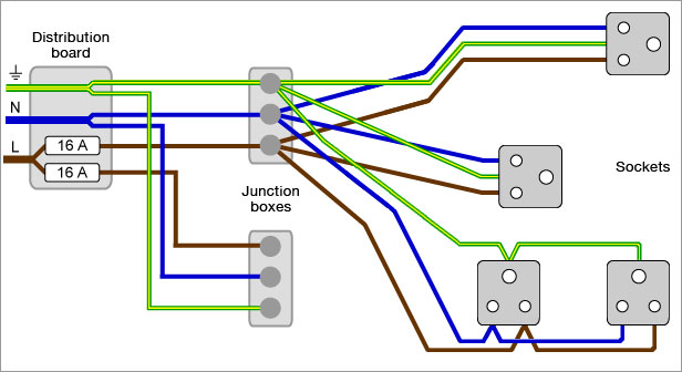

The EU Radial are multple branches or ‘radials’ that supply one or more outlet sockets & are typically proected by a 16 amp RCCB/Fuse
The socket plugs and the individual cable & component connect to that socket are procted by the 16 amp RCCB/Fuse.

I’d not say that. The ring main means it is difficult to predict with certainty that both sides will be balanced and since there could be a large current inbalance, a fuse is needed to cope with that potential uncertainty.
I’d call it a design flaw personally. I’m sure it seemed like a good idea at the time but overall the radial is the more popular. Worth noting, even in the UK the ring main isn’t the only method. Radials sre also common.
