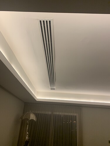

Wondering if anyone has encountered house ceiling noise issues and whether they have found a way to solve it. I am facing noise issues such as rattling noises and vibrations. The ceiling is gypsum ceiling which hides away the drainage pipes and ducts, and the AC ducting, above that is concrete ceiling.
When playing at 9’oclock with songs where the frequency drops below 100 Hz, the ceiling emits vibrations and noise. I played a sweep frequency from 50-100 Hz, you cannot see the ceiling shake or vibrate, however you hear the vibrations and rattling noises very clearly. There are two AC ceiling vents, one of them is just above the speakers and second is just above the listening position.

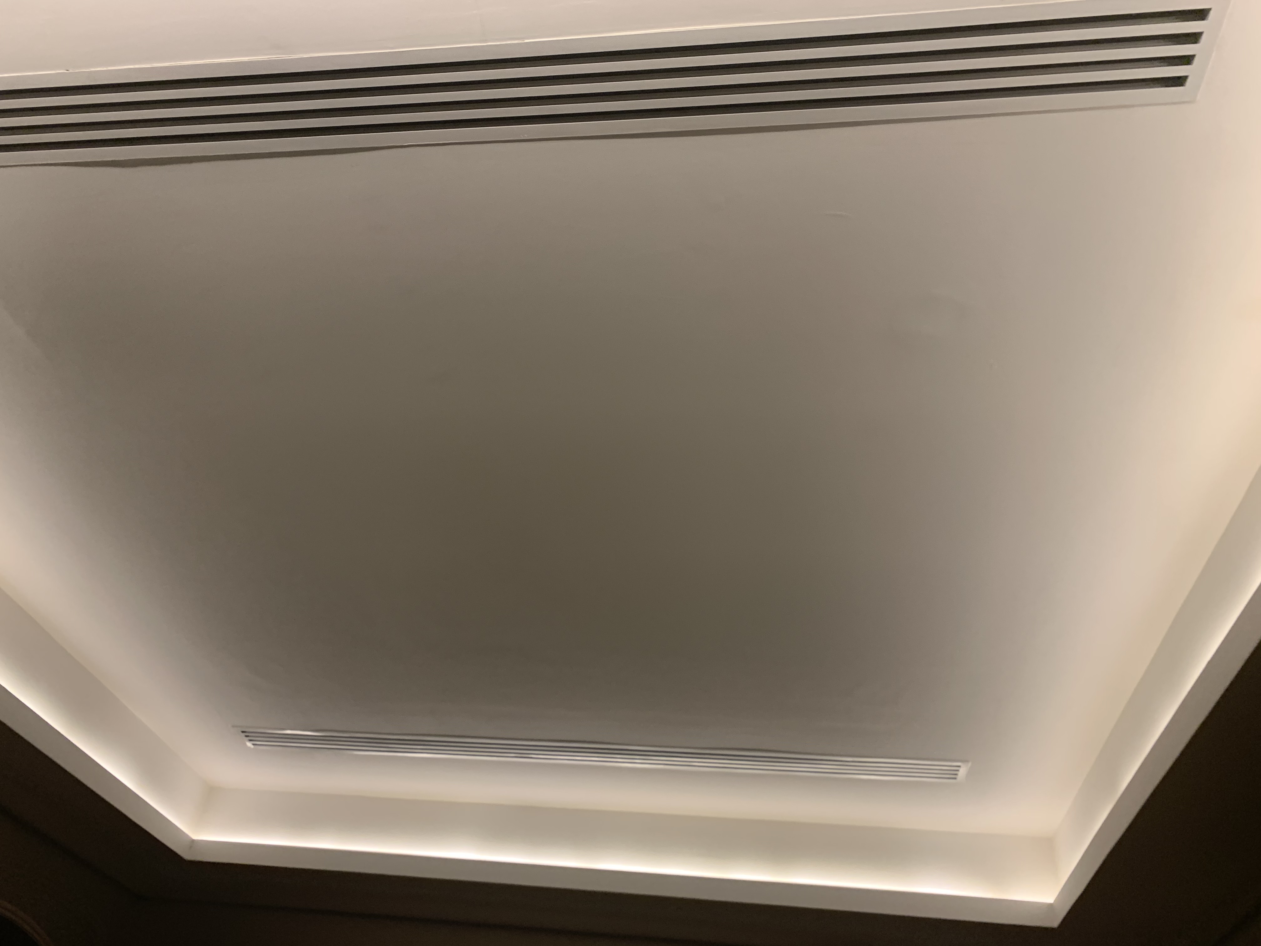

The problem is that I have no access to the ceiling, to do so, i would need to remove the AC grille which is not possible since it is plastered into the Gypsum, so to remove the AC grille, I will have to cut the AC grille.
I am attaching a picture for easier reference.

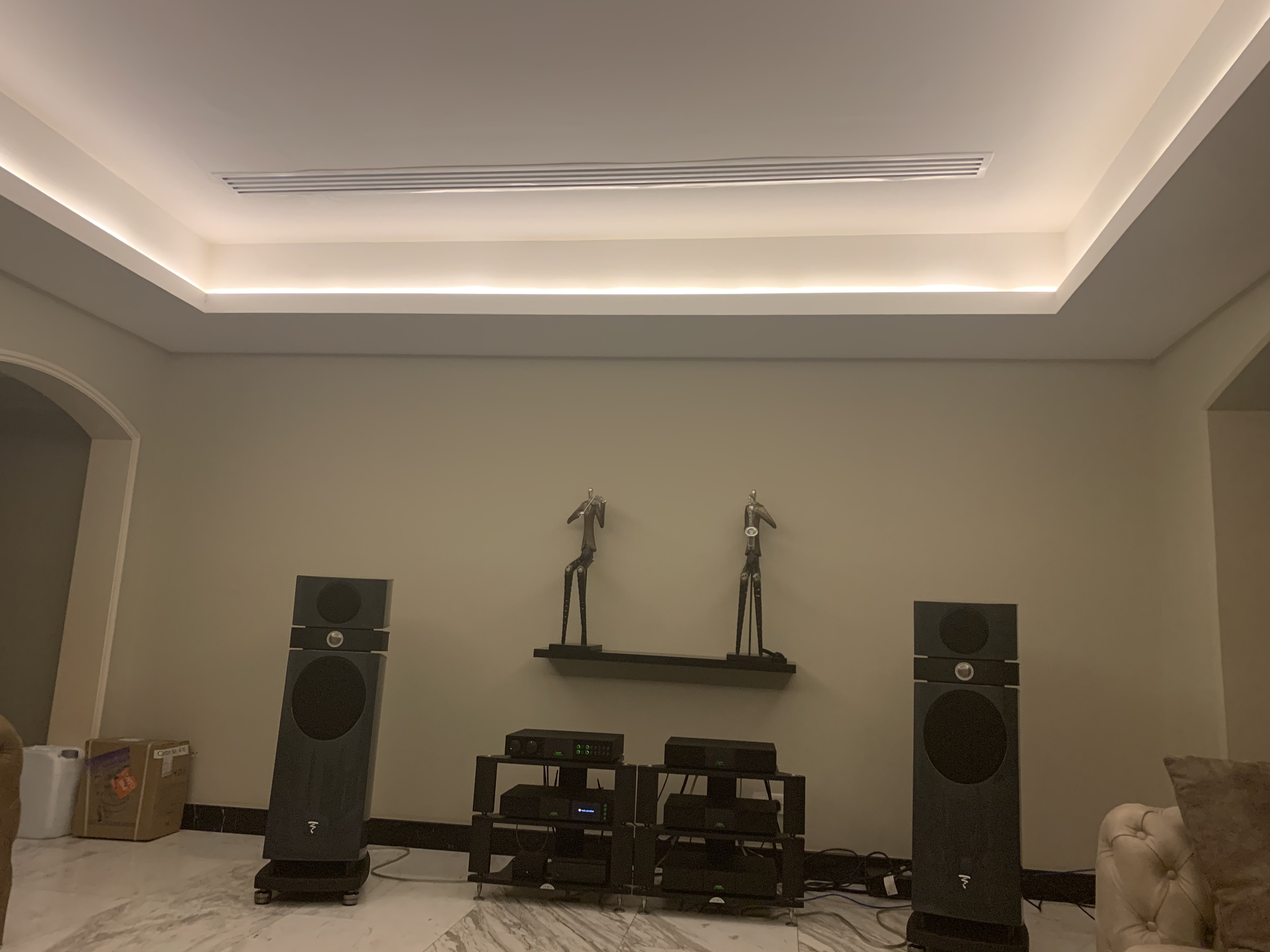

To make a ceiling per se making vibration noises is of course likely to be the result of low frequency pressure build up in the room itself causing in your case the weakest link ( the ceiling) to vibrate.
If you are actually hearing an in-room bass lift, I would measure it for amplitude/ frequency and treat your areas behind the speakers with absorption ( tex GIK monster bass traps) starting with the corners. I am fully aware that this option won’t be likely to suit the aesthetics of your room, but to me actually looking at the cause ( now you know the effect) is the logical place to start.

I have indeed done my REW measurement and e-mailed Lukas from GIK, he has recommended Soffit bass traps which will even dampen further compared to the Monster traps, i am considering the portable version since this is my living room and happy wife = happy life :slight_smile: , but Lukas was not able to confirm how much effect they will have since i do have a considerable bass build up.
You do not feel it in the majority of the music, however you do feel it when the bass really drops low, and I am not talking rap or drum & bass, just regular music such as Together for The XX from the Fiction album. The songs sounds amazing until a huge bass build which starts at 1:28.

I still think I have a major issue with the gypsum ceiling since when I climbed up the ladder and literally plugged my ears to the AC grille (needed a bit of an acrobat movements to do that), i could see or hear in this case that the main culprit is in the gypsum ceiling, hence the reason i am leaning to changing it, but my question here is, how, what is needed, and to what extent?
