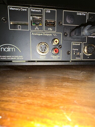

However I’m still a bit confused, as the Nova manual shows 5 pin as you mention, however mine only has a 4 pin socket?
No worries, I guess it’s amistake in the manual. Mine also has a four pin DIN output
Hi cwego
I think your ground switch should be set to default.
Hopefully others more knowledgeable can advise.
Ah ok thanks for that!
Sorry to mislead you. I went by the manual for the Nova.
As I learnt today, the manual is wrong. Bizarrely the Star has a 5-pin outlet and the Nova has a 4-pin outlet.
The DIN5 is an input on the Star, Mike. Pre-amp out is via RCA only on the Star, rather than the usual DIN4 (and RCA) sockets found on the Nova.

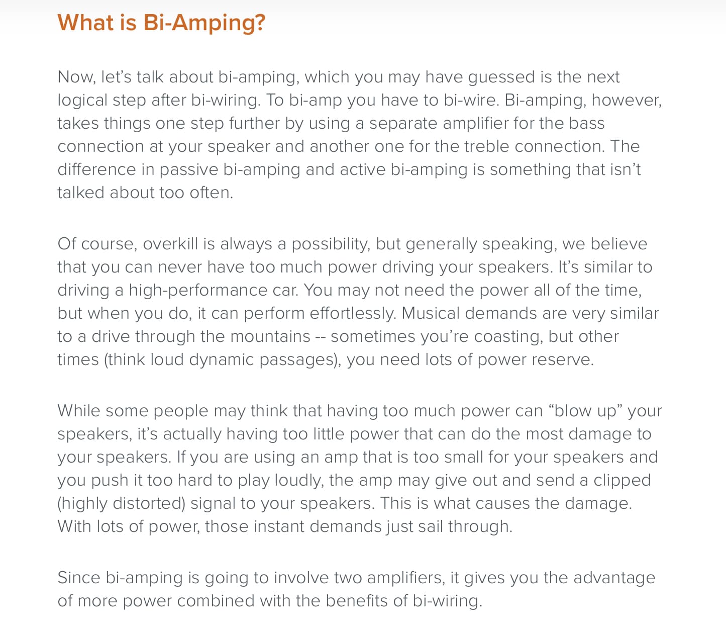

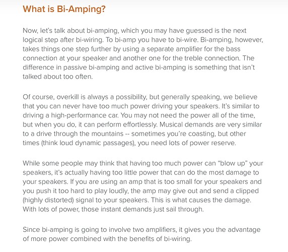

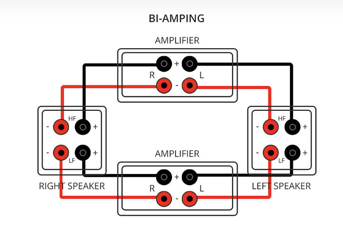

I understand that this is a “sensitive“ topic on this forum, but I would advise you to try out and drive your bass with the Nova and the treble/midrange with the NAP 200.
I do this with my KEF Ref 5/Nova/NAP 250 with excellent results.
It comes of course down to your listening “circumstances”: room, source ( in my case Qobuz Hi-Res mostly or alternatively Hi-Res radio via my Nova) and volume (in my case low to very moderate as I live in an apartment with sensitive neighbours).
I can add that I trust my ears as I attended a highly recognised music school in my younger years after a thorough admission process and subsequently have “certified hearing” :laughing:
Thanks that’s very interesting.
Can I ask, how do I practically do this as I’ve no idea!
Remember to disconnect the low and high range in the back of your speakers before you connect the amplifiers!
That’s fantastic info, many thanks!
