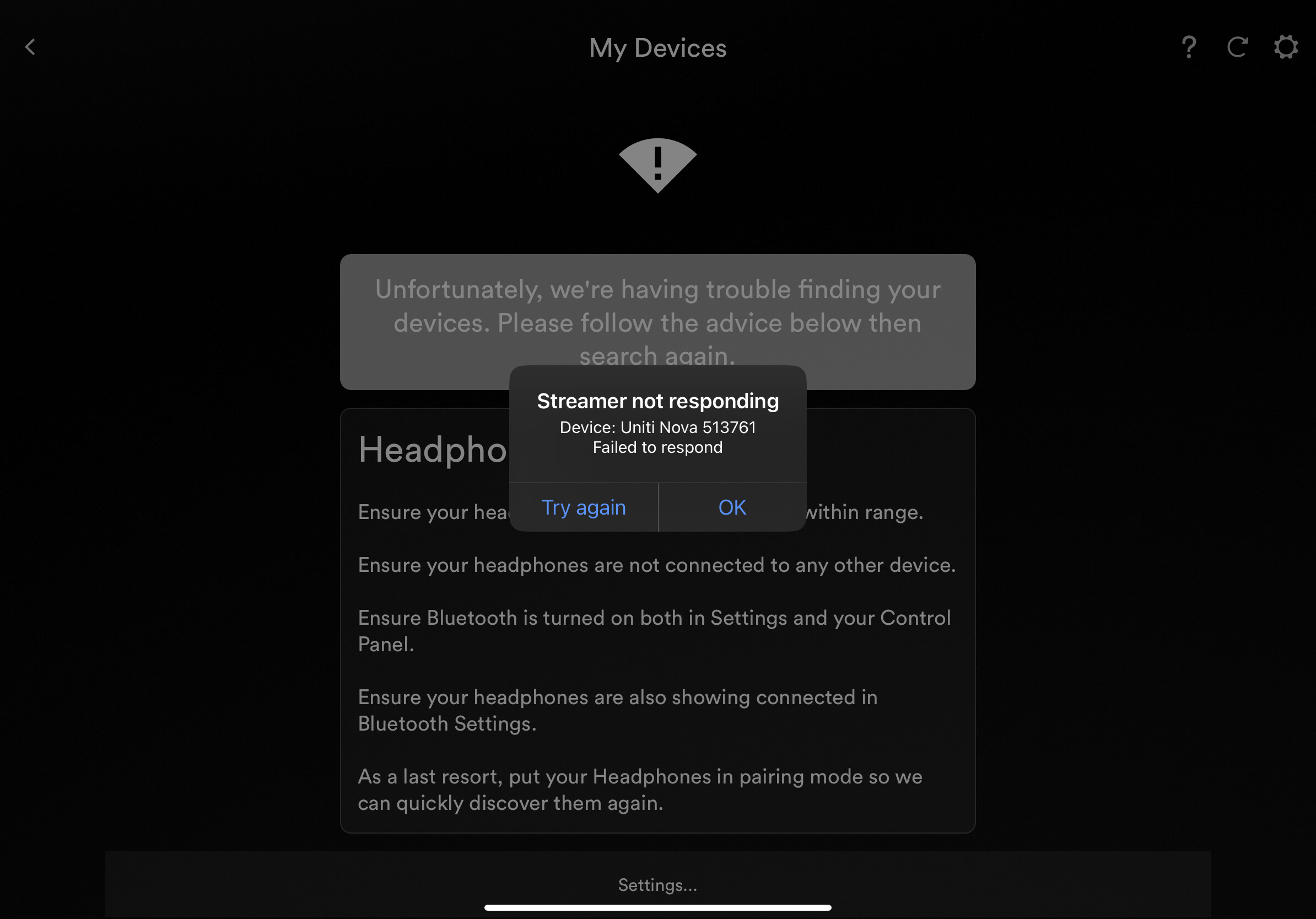

On rare occasion, a week will pass without listening to my Nova. When attempting start-up with the IOS app, I often run into trouble. After numerous attempts—the app will finally “find” the Nova and everything works.
This time, it’s been a week-plus and I cannot get the Nova to respond to the app at all.
App tells me Nova is connected to the same WiFi as my IOS device.
However neither iPhone nor iPad will connect to Nova (all are on save WiFi)

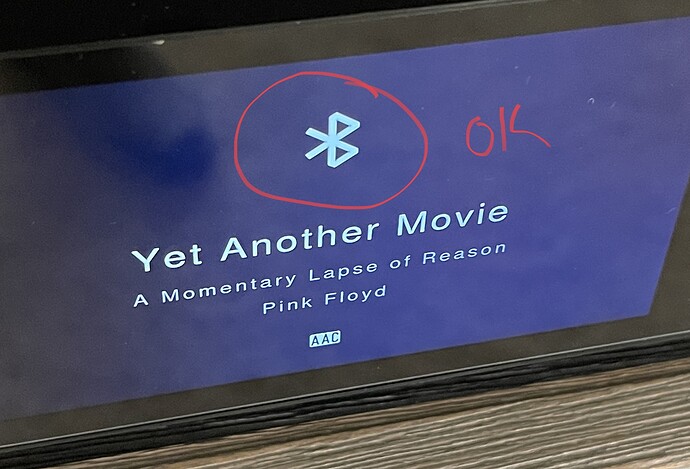

Bluetooth streaming DOES work:
a. IOS Bluetooth is “on”
b. Nova Bluetooth is set to “on”
App fails to connect/trigger Nova.

This problem has been reported in several different threads (have a search) and it is a problem that Naim are aware of as I understand it. Look out for an app update (date unknown).
Have you tried restarting the Naim app? So swipe it up and away then reselect it.
Another thing you could try would be to connect the Nova using Ethernet rather than WiFi. You can buy a cheap cable long enough to just lie across the floor from your Nova to your router. Any old cable will do and Amazon will deliver it the next day if you choose the right supplier. Plug it in, turn the Nova off at the mains (not just using the front panel button) and turn the Nova on again.
This is the iOS app loosing comms, its not the Nova connection.
IME it can fail to connect (Finding Devices) but will eventually connect. Once the connection has been established, it may last for hours or minutes, there is no pattern or sequence that I can find that causes it to fail again.

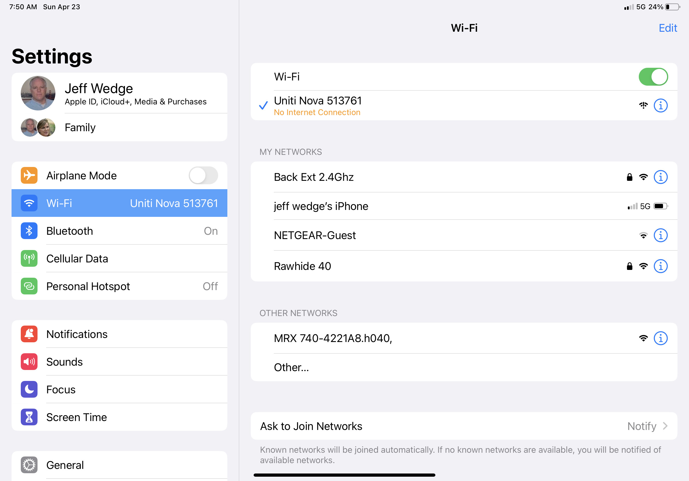

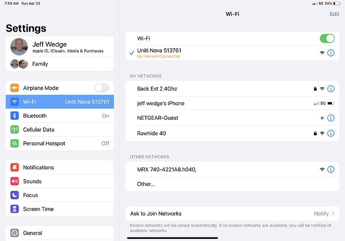

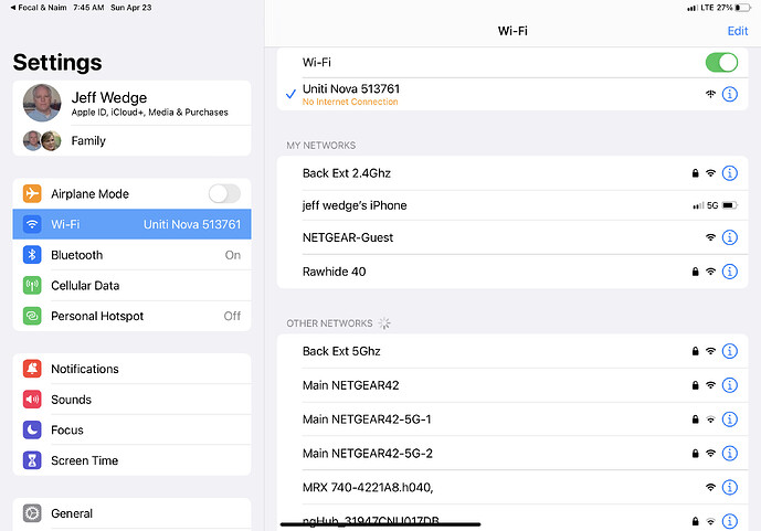

Why do the screen shots show your Apple devices trying to connect to the Nova Wi-Fi Direct, which is only used for initial Wi-Fi setup? Your Nova should be connected to the Wi-Fi of the router. Your Apple devices should also be connected to the Wi-Fi of the router. Looking at your Wi-Fi list you seem to have a Wi-Fi extender in operation. I have never had much reliability when using them. They are OK for basic internet access but not good for local network streaming (between devices). I would always suggest a MESH system if you need extended coverage. I use an Orbi system with 3 nodes and never have any issues with ANY device.
Excellent input. Regarding the screenshot and the direct connectivity, I was attempting any sort of connection to run down the list of solutions.
Secondly, negative on the extender. I do have extenders in the home, but the WiFi router I use to support my Nova is not an extender.
