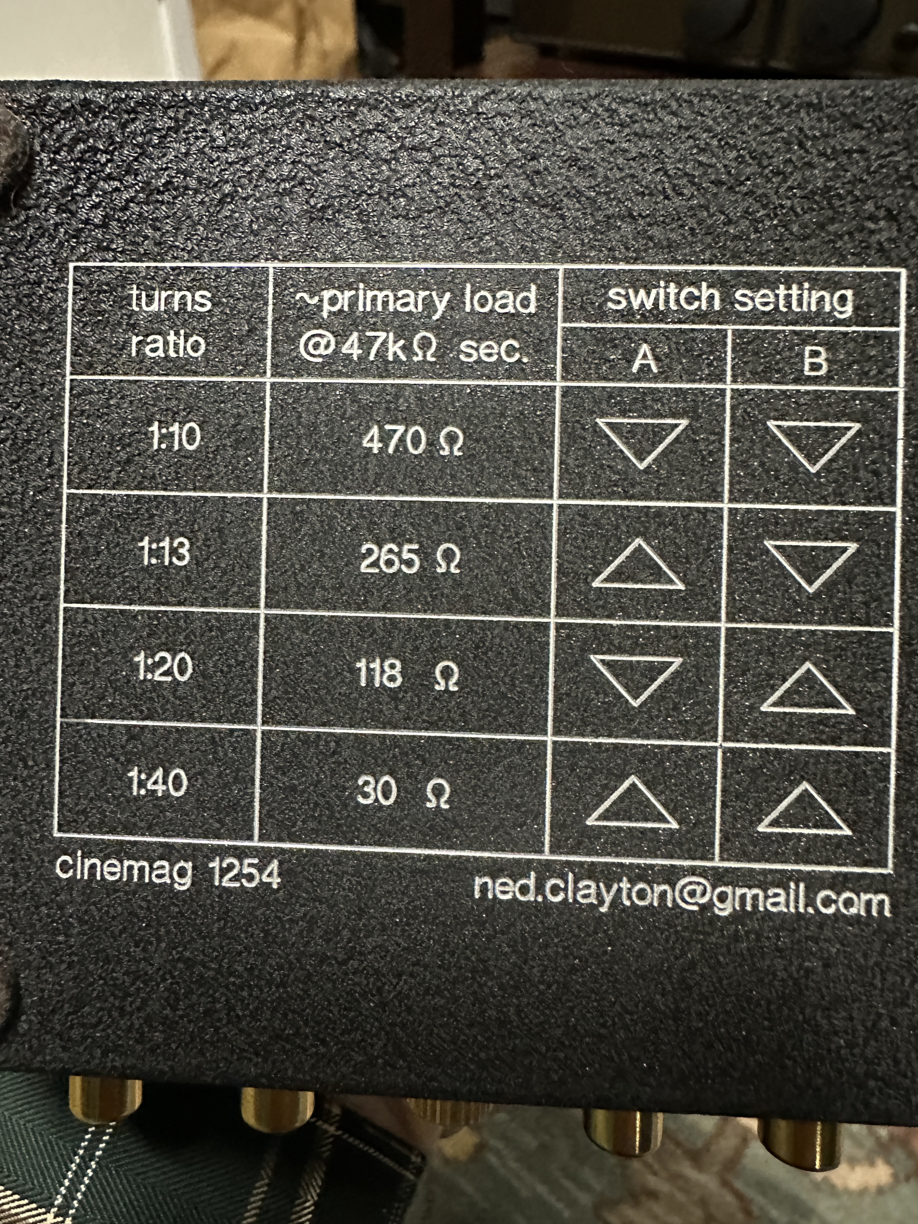

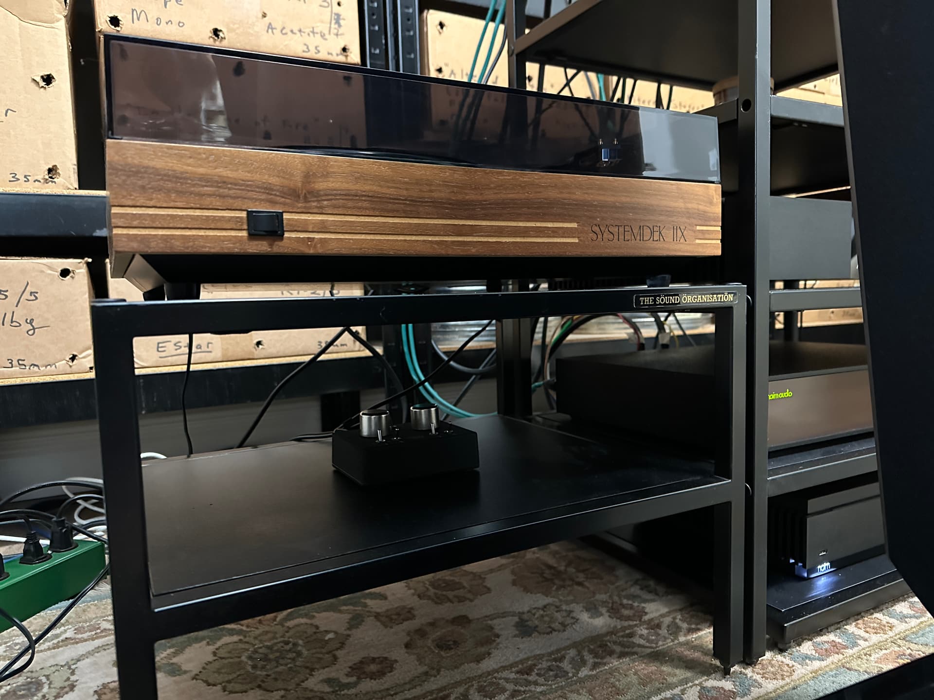

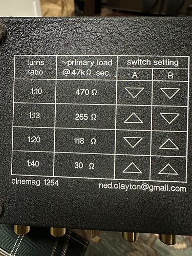

To conclude my experience, i purchased a SUT from Ned Clayton on ebay. It uses Cinemag transformers and is configurable to 4 ratios: 1/10, 1/13, 1/20, 1/40, and 3 different grounding options. I plugged the Systemdek into it and used standard el cheapo 3 foot RCAs to plug it into the NVC-tt. I positioned it below the Systemdek and to the left of the olive 250 and Npx300. I grounded it to both Left and right channel at the Sut itself.
Absolutely zero hum even when turned to maximum. Sound is excellent. And now with the flick of the MM/MC switch on the Nvc-tt i can move back and forth between the stereo and mono tables with ease.
I experimented with the different ratio options and settled on 1:13 as best. When i asked chatgpt what ratio would be best with the internal resistance and output voltage of the AT33Mono it did the math and suggested 1:14 or 1:15…so my choice of 1:13 seems best!
