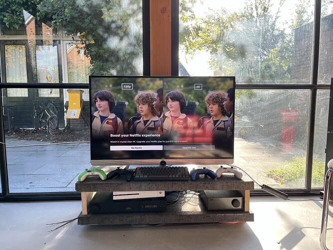

Wifi is indeed good sofar. It starts nearly immediately when watching a movie.
The image quality is excellent for our low quality netflix account (why use 4k if upscaling is near perfect). What I did not expect is the improvement in sound quality which was immediately obvious. Its like a source or pre-amp upgrade. You’d expect bits-are-bits but then it works out differently :slight_smile:
We have a Fire stick too which is fine really but this feels a nudge up indeed.
If you are suffering poor sound quality on Netflix, particularly dialogue, I have a tip which may help. Once you start playing a programme go to ‘other’ settings at the bottom of the screen. You should see audio options on the right hand side. Unless you have a 5.1 setup, switch from English 5.1 to English stereo. It’s either called stereo, 2.0 or normal.
You’ll find the dialogue is instantly and dramatically improved!!! Nearly all their programmes are automatically shown in 5.1.
There is a small difference but not worth the euro 10 a month.
I pay for “premium 4K” for Dolby Atmos. with or without 4K doesn’t bother me so much.
