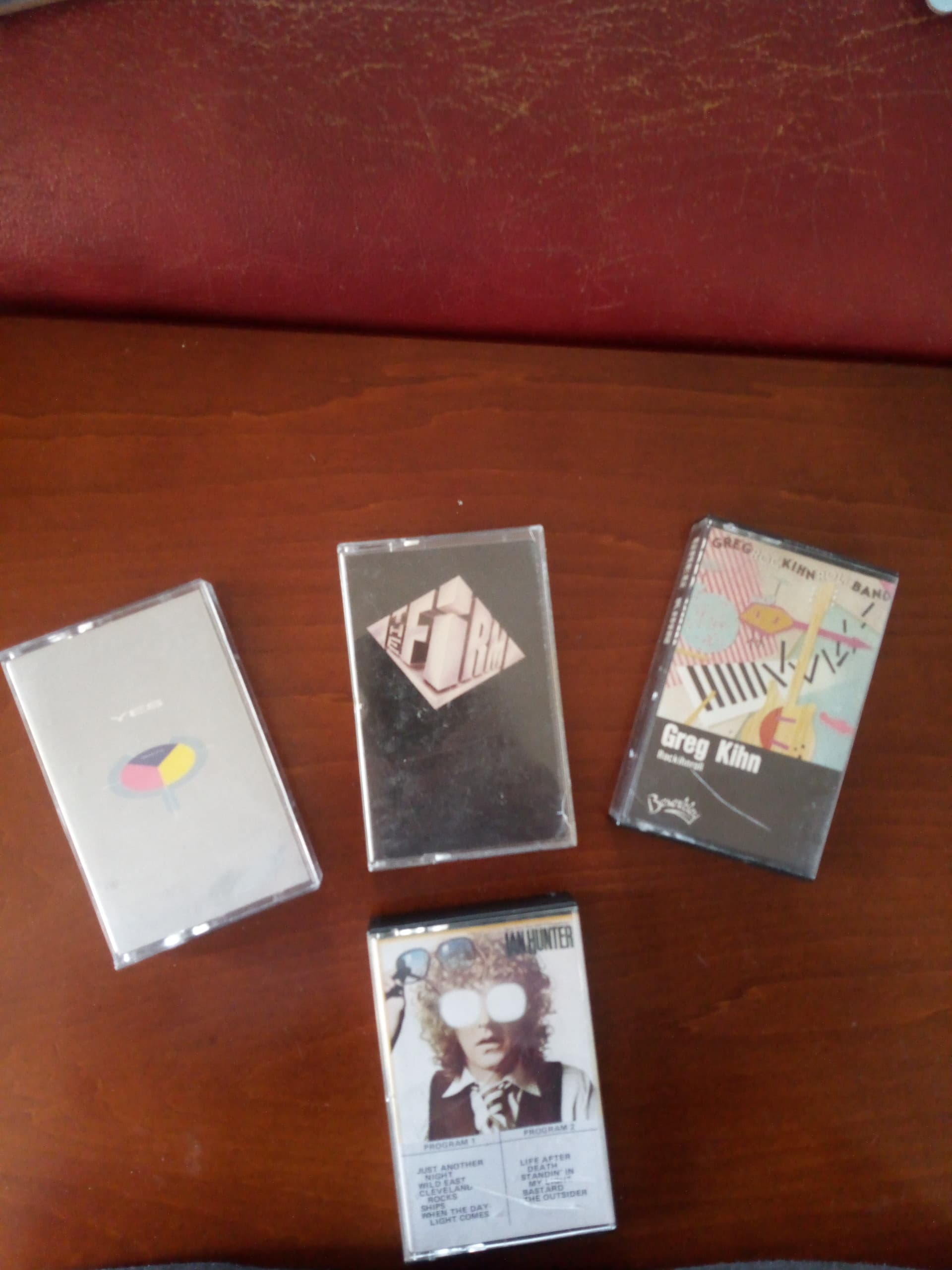

Anyone have any thoughts on how to properly lubricate old cassettes?
YouTube is conflicting and most other research says don’t use wet or dry silicone

Shouldn’t be necessary, what playback issues are you experiencing?
Oooh, The Firm…saw them in Detroit when they came out with that album. My only chance to see Jimmy Page live.
Wows & flutters also dragging on some older tapes.the cassette player was serviced ,most tapes play fine
IIRC it’s only 8 track tapes that often require lubrication as the cartridges contain part of the mechanism.
I have had that problem too in the distant past. What I did was to open the cassette and move the tape to another case which contains floating leaves of plastic between the tape and the case. I discarded the tape in the other case. I think TDK and Maxell tapes included these floating leaves.
If I’m about to play a cassette that hasn’t been played in years (or even decades) I find it helps to just fast-forward then rewind the thing before playing. Helps keep your tape deck in shape too.
Good call. I have a Technics RS-M85 just for winding tapes through if they haven’t been played for many years.
Dual capstan drive is also a good antidote.
