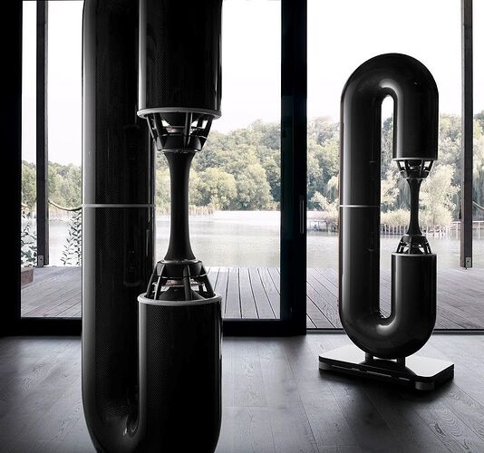

The most intriguing actual speakers for me are the Bayz. Different technology than most.

I was able to listen briefly to the larger Bayz. Very deep and accurate bass extension. Very impressive but not enough time to have a more complete impression. They , I believe are in the 200K US dollar range!

They have one contender : MBL X TREME
If I don’t write silly things, I think they use similar technology. Unfortunately I have never heard them.

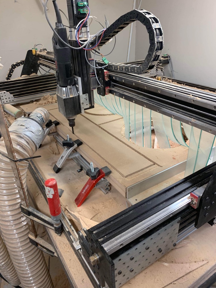

Did you make the horn assembly or did you purchase them pre-made?
Do you have your own CNC machine?
A friend of mine do it for me. DBO is fine when DIY isn’t an option. :sunny:

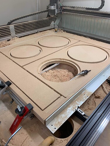

Active crossover. With DSP. Bass system is a slot loaded open baffle. Drivers are two 15"JBL 2226H and two 12" 18Sound 12MB1000 drivers. Crossover at around 900Hz.
They will play on one power amplifier, but because the 18Sound driver have higher resonant frequency (fs) it will work better in the mid bass area. (Or something like that - I am not the guy with the knowledge here). My friend made his own CNC machine. Good to know guys like him.
Midrange/tweeter will be a Radian 950PB driver with Truextent beryllium diagram. I also have a Yamaha tweeter, but perhaps it is not necessary to use that. Horn is a TAD TH4001 clone in wood.
The boxes are made of 38mm MDF and milled. Braced inside and made even stiffer with fiberglass. I will have them professionally veneered.
