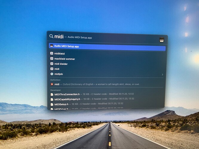

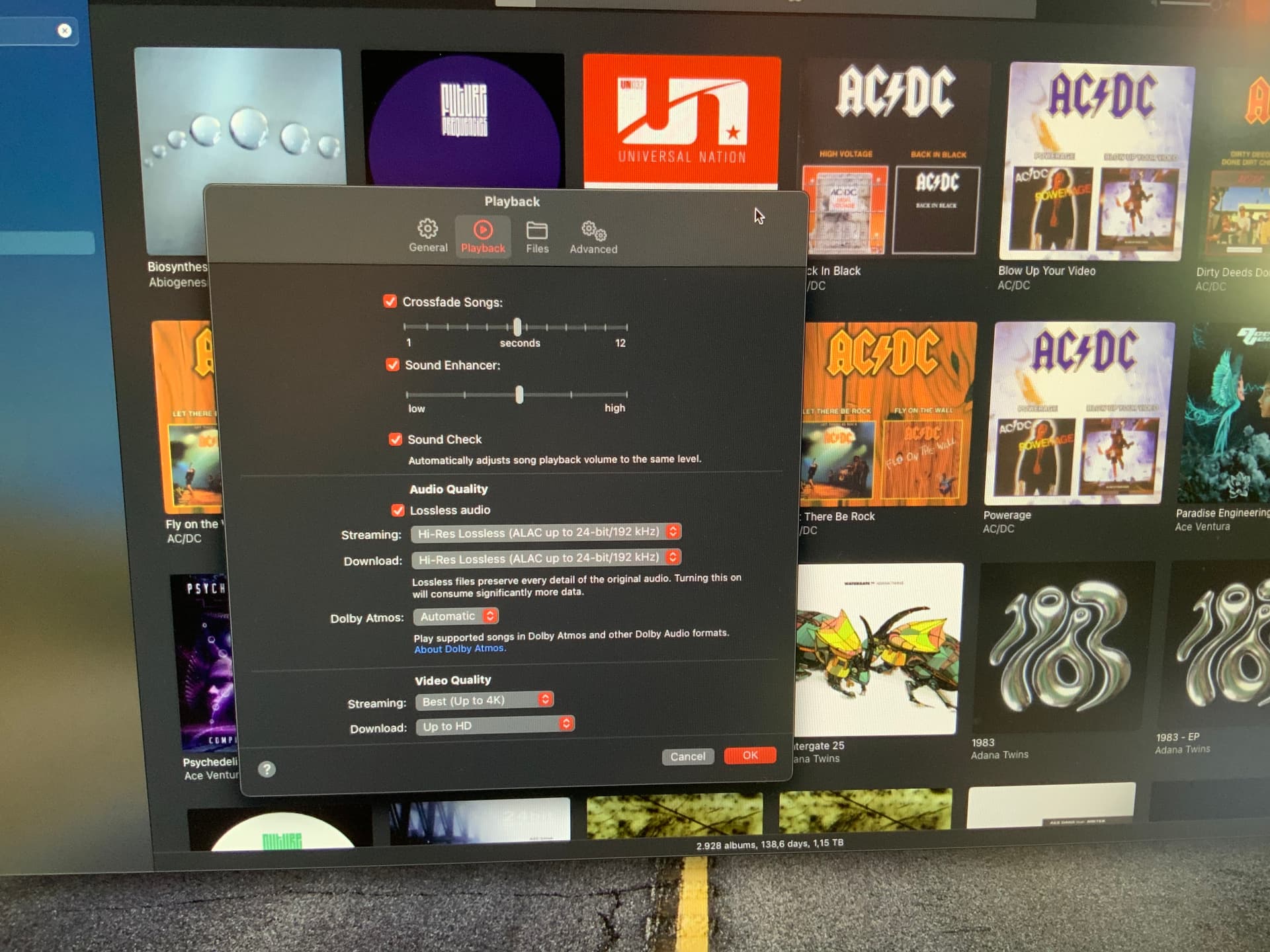

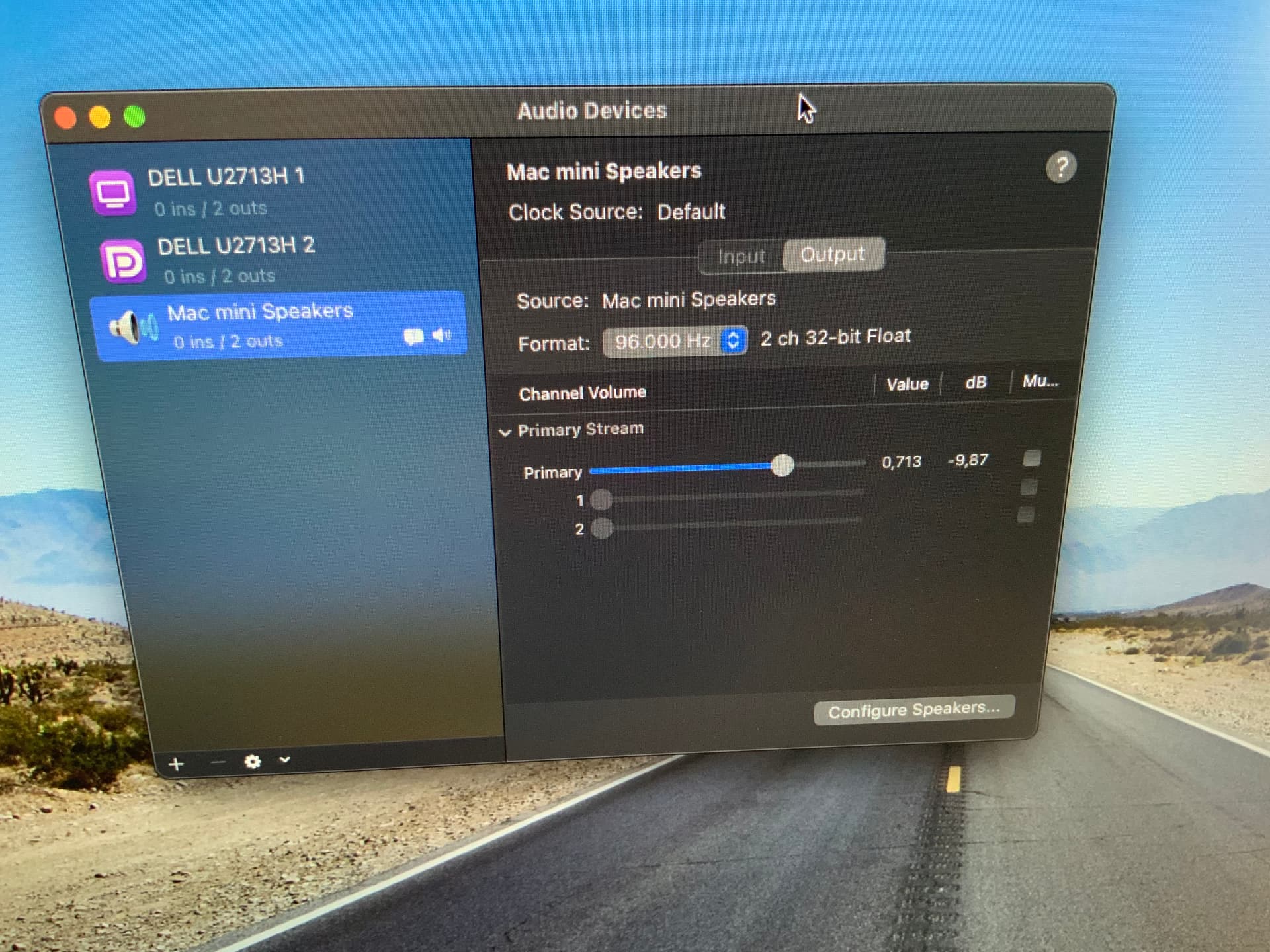

This is bull*
When using apple music you can use equlisation and other sq improvements. Also apple Music is not Bit Perfect, meaning you have to manually set the bitrate to the max supported by the interface. Please make sure it is integer multiple of the original source bitrate, otherwise some artifacts can arise. Just use spothlight and type midi. Its self explantory.
Play around and see what happens.
Sadly this won’t change anything ![]()
