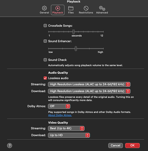

Apple Music (and Amazon HD) is incredibly annoying as without an external DAC (which you have) it is tricky to stream without a physical connection to Naim’s streamers. Airplay 2 is CD quality still (it’s pretty good though).
Check the Apple Music Preferences they probably should be:

I have already installed Audirvana Studio on the Mac Mini. I like the UI but it’s not much use because I have to use it in “legacy mode” with Apple Music, which means the various checkboxes to de-prioritise other processes on the Mac are not available.

Another issue with Apple Music as I hinted at earlier is that there is no way to simply integrate it with Audirvana/Roon/Naim streamers etc etc as Apple despite touting hi-res lossless have no clear methods to output this apart from using an external DAC driven by recent Mac hardware.
