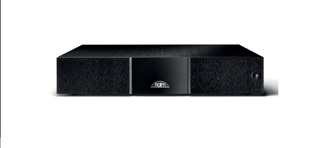

I’m curious if Naim or authorized service centers are able to retrofit white LED for the center front fascia Naim logo?
I’m specifically interested in the 555ps , but assume the same answer might apply to the range of OC products?
The 555PS DR is sold new with White LED. Can this be retrofit?

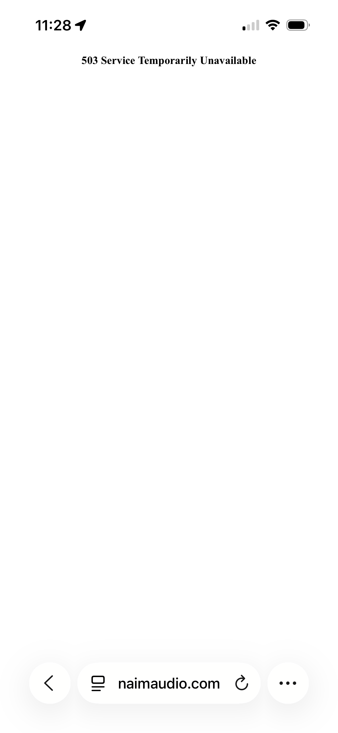

Unfortunately Naimaudio.com not responding here in the USA. Classic : ]

Official response from Naim Support for future reference:
“Although it is technically possible to retrofit the white logo to the Original Classic range on certain units such as power supplies, it is not recommended by us due to the voltage differences between the L.E.Ds.
This becomes even more complicated when it comes to other products in the O.C range such as streamers, as this involves software being rewritten on the streamer boards to compensate for the voltage changes, therefore it was decided that retrofitting Green logo units with white logos was unfeasible.”
When I pushed for clarification on OC power supplies, the 555PS DR specifically:
“We do not provide this service due to the board changes necessary to adjust the voltages between the green and white logos.”
