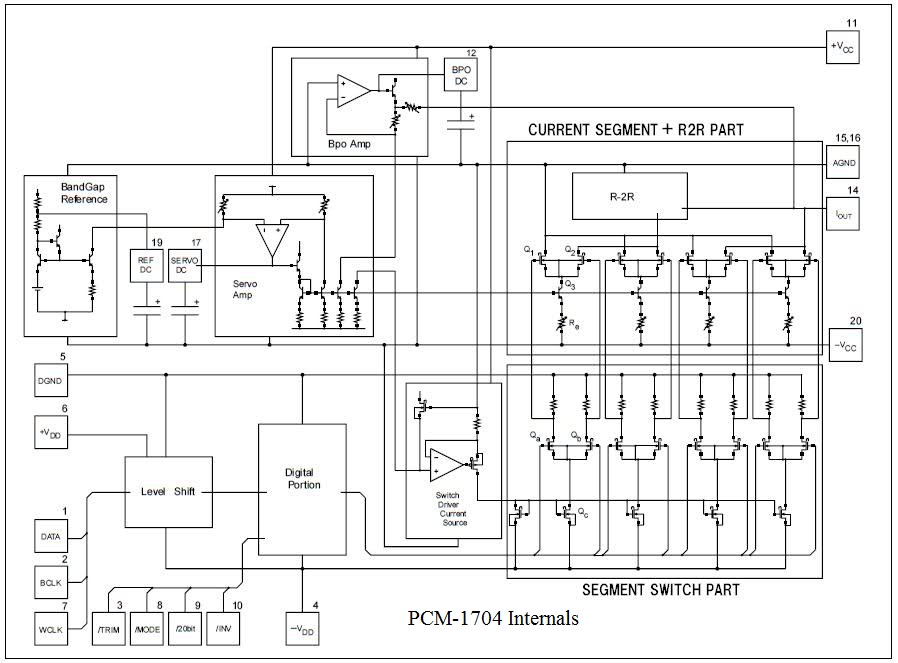

So I think I read that the 16 bit data word is read at 8 x 44.1 kHz which equals = 352.8 kHz. Possibly and I am making this bit up to write a stereo voltage point for both left and right channels the SHARC processor is running at 2 x 352.8 kHZ (unless there is two of them, one for each audio channel) = 705.6 kHz.
Anyhow back to one channel at 352.8 kHz, this data word with averaged out jitter from 8 reads from the SHARC processor is sent to the digital low pass reconstruction filter which is the SHARC processor and then fed to the Burr-Brown PCM1704k DAC where we find our left and right channel stereo audio output voltage points to be fed to whatever buffer amplifiers and more amplification until we obtain our 1 v pk-pk output audio waveform or it might be 2V pk-pk waveform.
Question: Does the laser actually scan the data word on the disc 8 times to feed the 8 data words to the SHARC processor? This is how I would think that jitter can be averaged out. Possibly another topic.
I do not know if the SHARC or PCM1704k ADC can clock a single 16 bit word or a double word of 32 bits. 16 for left channel and 16 for right channel.
Question: I am missing where the PCM1704k can handle 96 kHz sample rate and then process unto 768kHz. Is this what you mean that NAIM overclock this DAC?

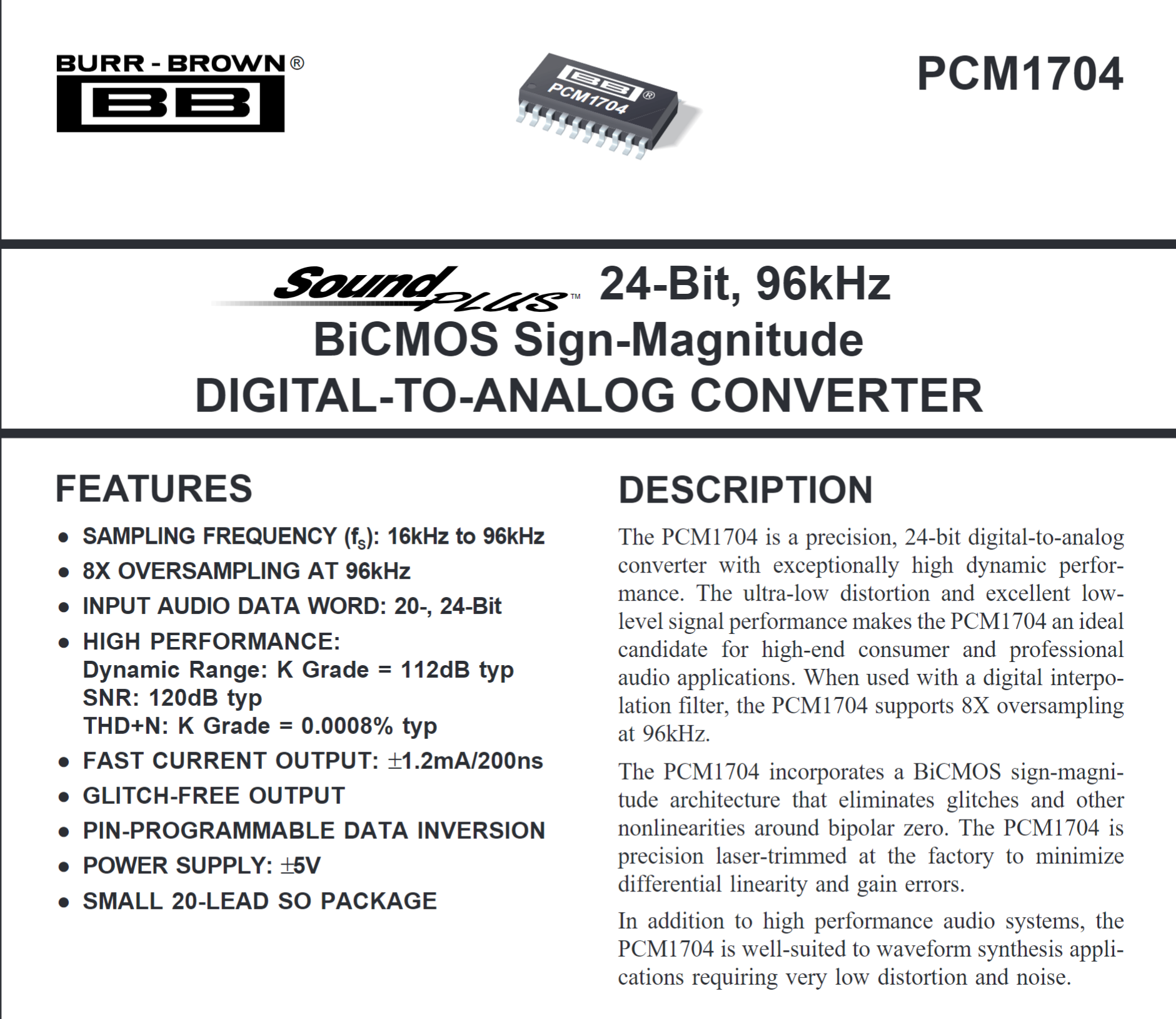

These are the specs of the PCM1704:
8x oversampling at 96Khz results in a virtual sampling rate of 768Khz.
Thank. you litemotiv,
I see my error that I was expecting 16 bits to be clocked in and a voltage out. There must be two of these chips inside the ND5 XS unless the output is multiplexed to each channel.
The data comes in on pin 1 and the current out on pin 14.
So therefore the data word is clocked in as a data stream.
I think I understand and maybe very incorrect that the data stream, each bit is sampled eight times to minimise jitter errors, thus I tentatively say averaged out and produce a current output on pin 14.
I am assuming that there are two data words, one for each channel thus we require a DAC that can run at least twice the 44.1 kHz frequency for each channel = 88.2 kHz. I see a large use of cascode differential amplifiers in the chip. Interesting. Though digital technology was never my forte’. I am an old analogue guy from my tech college days. Possibly the other inputs tell the chip how long the word length is or the empty bits are filled with zeros. Just a guess.
