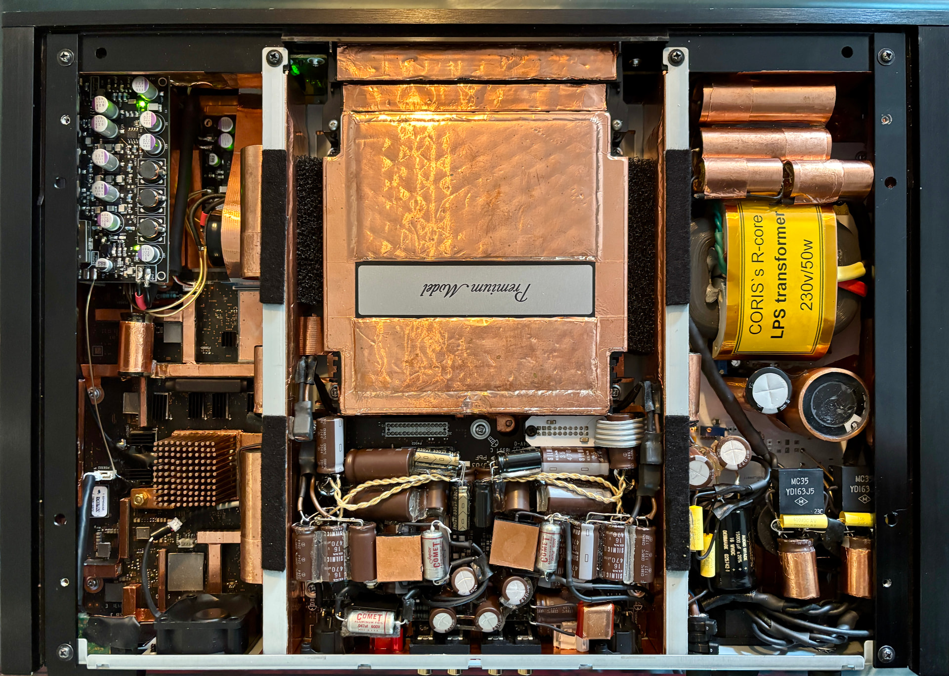

Many capacitors were replaced on the power supply board, the main board, and the disc drive. I’d love to see your player open :slight_smile: It’s not a modified Naim product, after all. I can understand that.

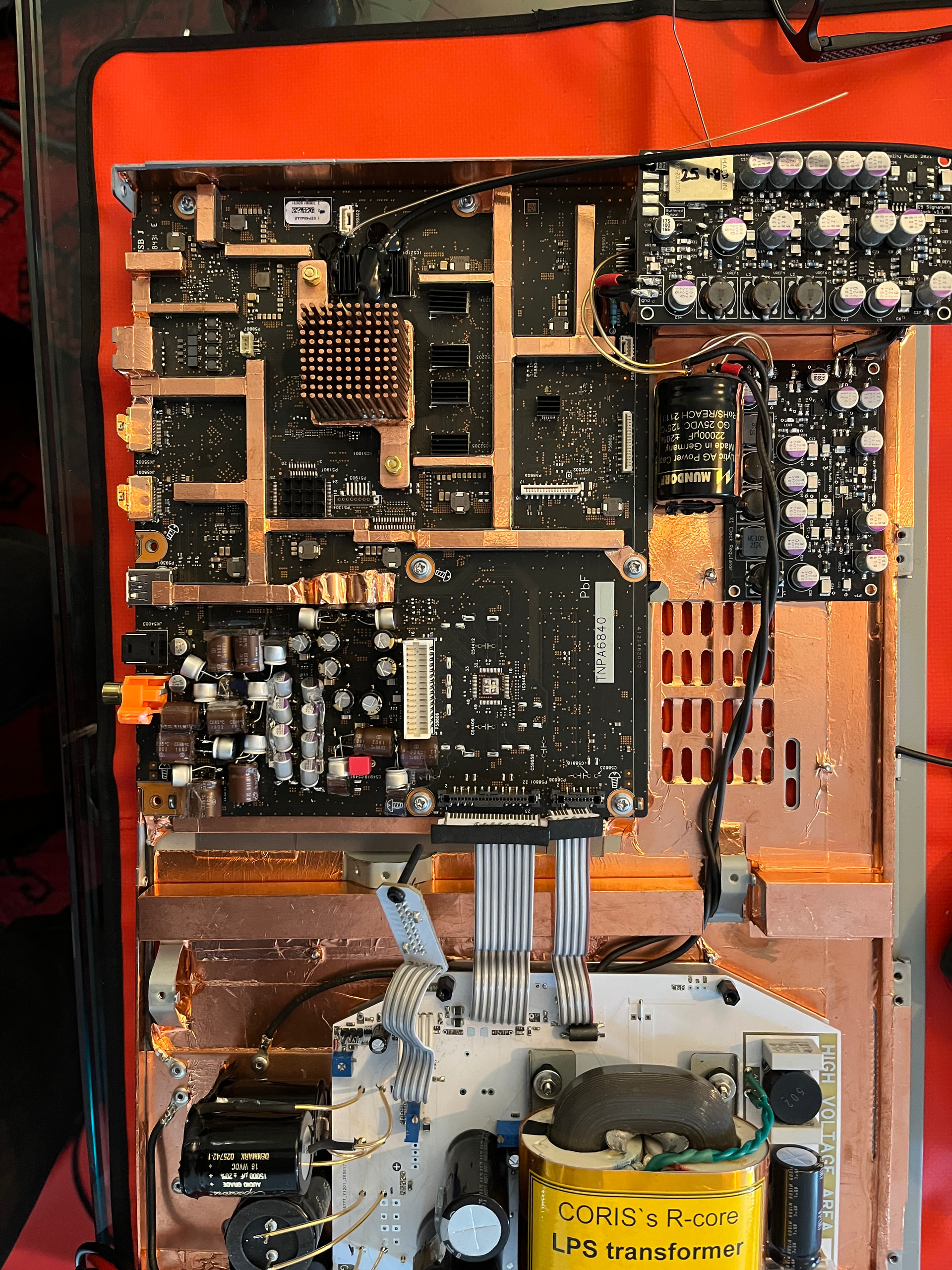

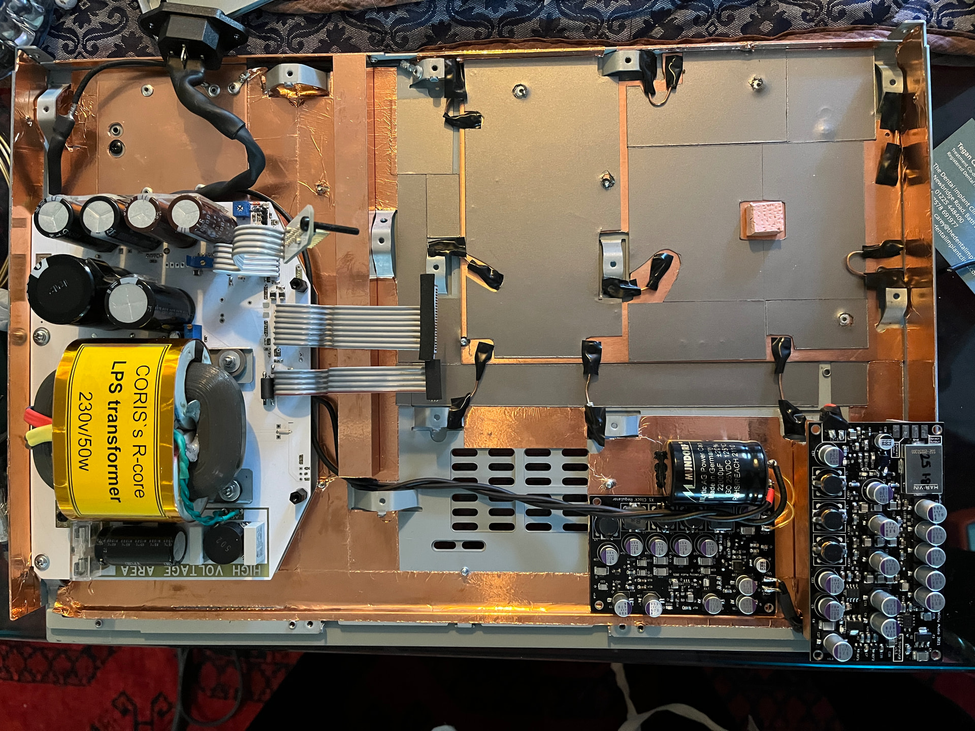

A few pics, it’s been a bit of a squeeze and its evolved with lots of experimenting
In the first picture, those are the grounding improvements. Are they the black cables between the copper foils?
How have the picture and sound improved? Were you able to compare it to a production model?

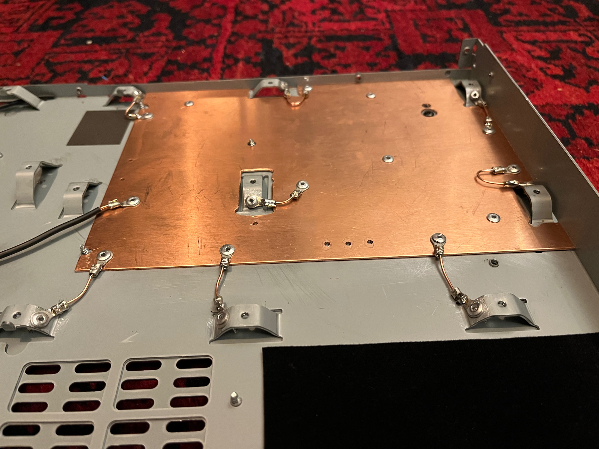

I have a stock unit with AKM DACs as a reference and have many times A-B’d single cap additions with soldering iron in hand. The Copper Chassis was a big upgrade so much so I rebuilt the modified unit in the original chassis. It really surprised me a big step up in Dynamics and ‘body’, projection and solidity. I added a GND plate and experimented with GND locations, the steel chassis acts as a GND link with the design - yuk. As you probably know steel is around 6% the conductivity of copper and is sonically not great. I foiled where the chassis links are made to the chassis so it was copper all the way through. I also used 3M EMI/RFI absorber to add to shielding and noise reduction. the black was just insulation
