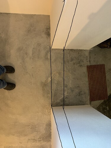

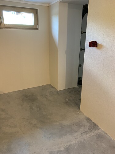

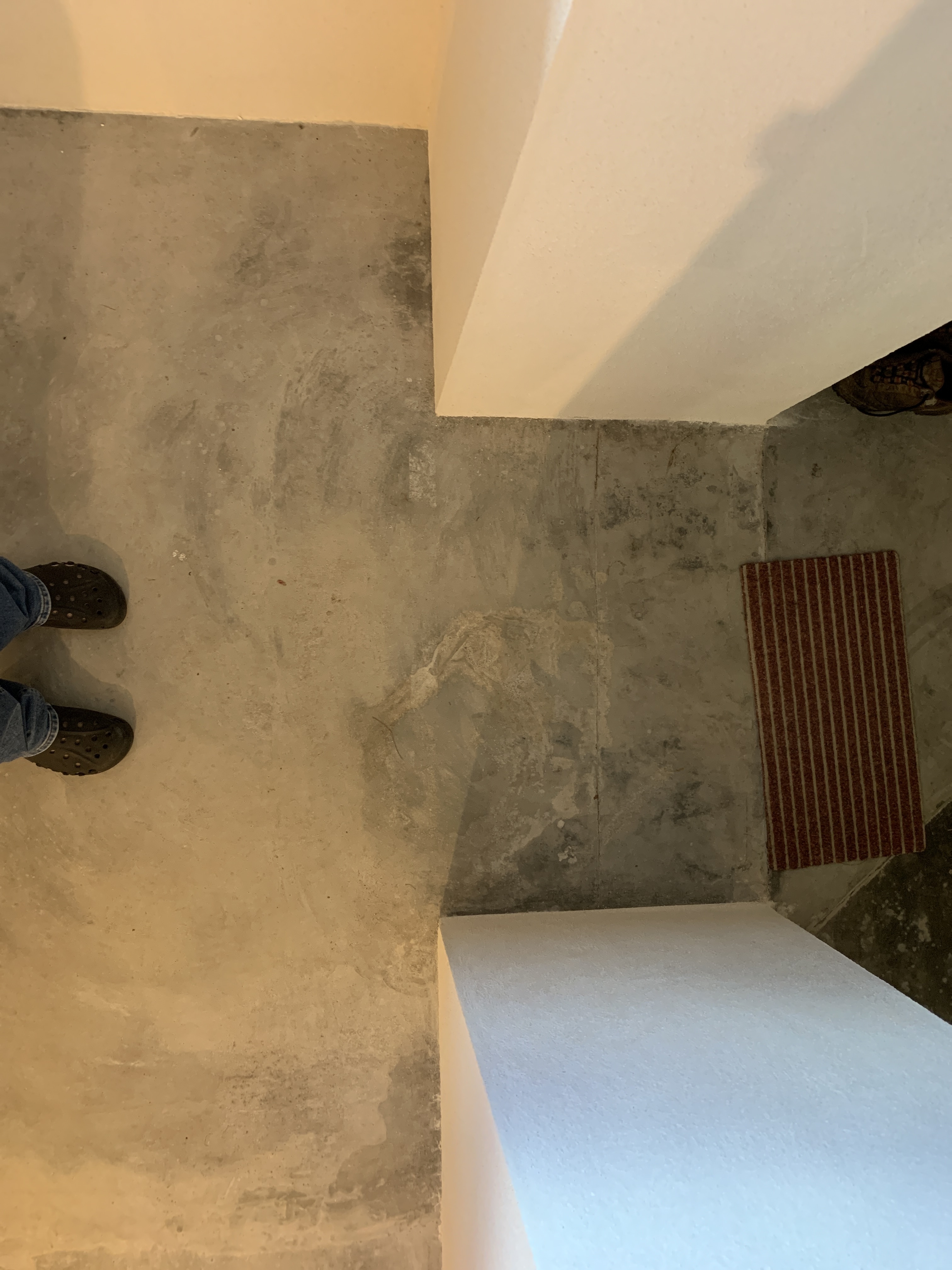

Sorry no time to read yet, but pictures paint a thousand words. Here is the door entrance in question. System will be to the right of the door, so only speaker cables (two channel plus centre and maybe Sub). I will ask the tiling firm to also try to propose a solution
From your pictures it should present no problems. I would channel out for the ducting so that the cable emerges next to the rack. On the other side, channel out so that the cable emerges near your speakers and close to the wall. That way the points where it emerges should not in themselves be a trip hazard and it should look discreet, as @ChrisSU.

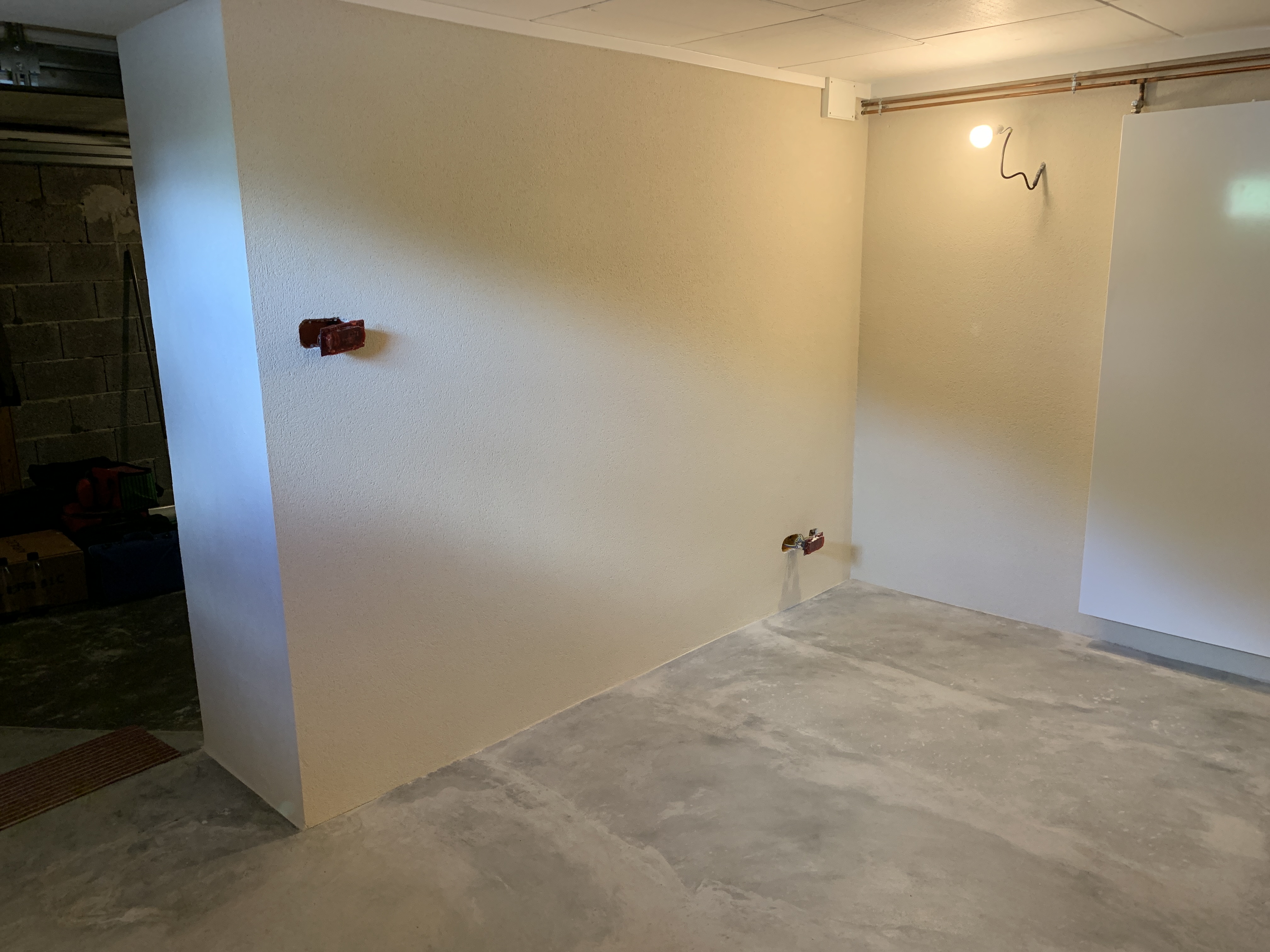

This is how the door will be installed
So tempted to channel in concrete from racks to corner of the room and add large ducting which will be covered by tiles. There is also skirting tiles that are 10cm high I believe. Sounds quite high to me.

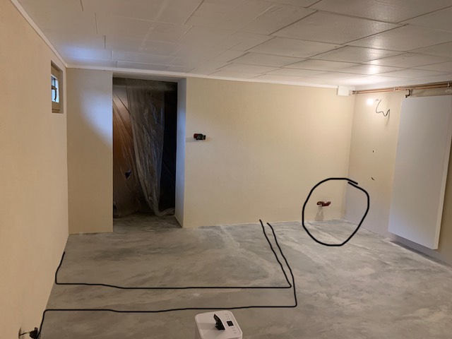

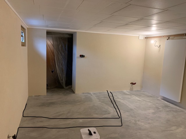

I may also explore cable runs (see attached figure) under rugs/carpets which are needed for the acoustics anyway.

It’s now looking like one of the two solutions outlined. I have a slight preference with channeling along the wall but there will still be exits in the tiles
Re above photo, why not have kit on same wall as speakers and save yourself a lot of hassle?
That was an idea, but I put my mains spur in the corner. Double socket near radiator
In any case, I still need to decide on short wall or long wall
I would still channel across the door and come up behind the skirting tiles, channelling into the bottom of the wall using plastic flexible tube to run the cables in. It will be messy to do but better now and get the job done properly.
